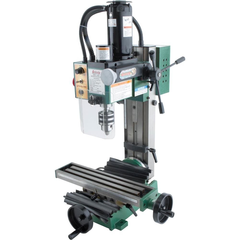

                Hey huntercf,
                I think something like this Grizzly g8689 mini milling machine for $575 would do the trick. You'd also have to get a vice that would mount securely to the mill's table.
                You could also use it to drill accurate holes for fire control group etc. Also I think you could probably resell it for a good percentage of what you paid for it if you decided not to keep it.
                Hope this helps
