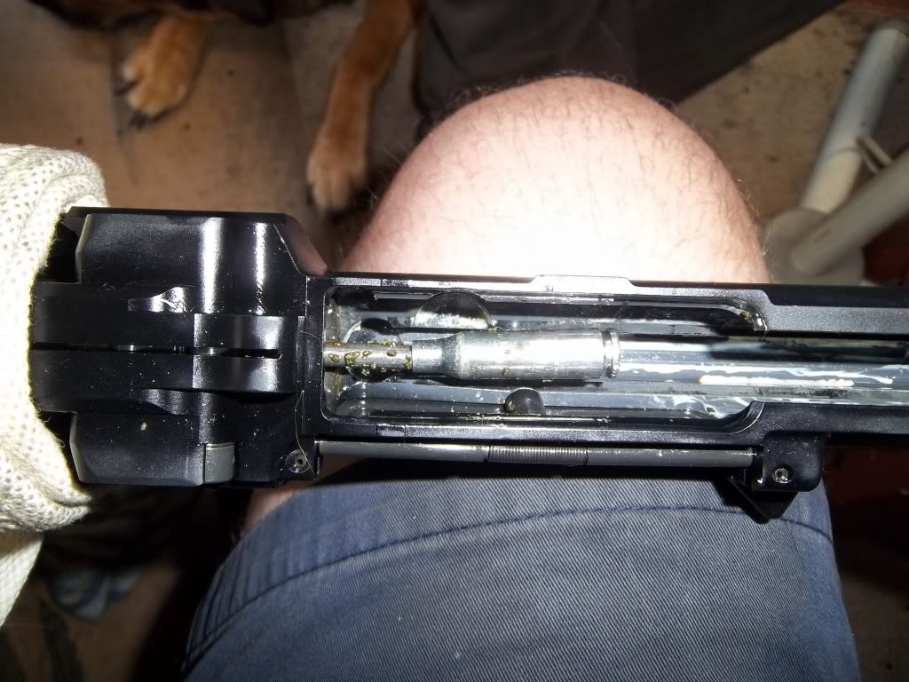

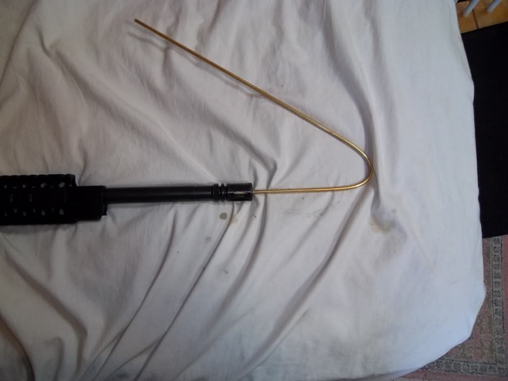

    Client has just brought me an AR upper, chambered in 5.56 NATO, with a 5.45x 39 round quite stuck in the chamber... He also attempted to dislodge the round first with a wooden dowel, then with a brass rod... I've gotten the brass rod out, and I'm soaking the chamber in break free and bolt off... Will post pics soon...

        Did the round fire or is it still live? I don't see how the bolt could even close on the larger bodied case.

                Yeah, um, no, will not fire another round through it... LOL The larger case of the 5.45 is really badly wedged in the chamber, compressed air hasn't worked, making the round inert now, already soaked the barrel with oil, and when I got the brass rod clear I noticed gunpowder on the end of it, so I'm hoping the powder is much less volatile...

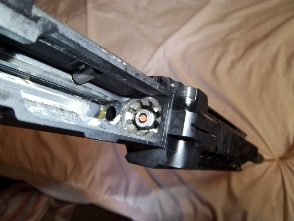

                      Pictures as promised:[IMG][/IMG] [IMG][/IMG]

                        What a P.I.T.A...

                            Wow.... So, did your client give you a straight answer on how that happened? I mean...

                              Well it looks like you are getting pretty good at fixing others mistakes CC, glad this one worked out. Guess your client learned their lesson
