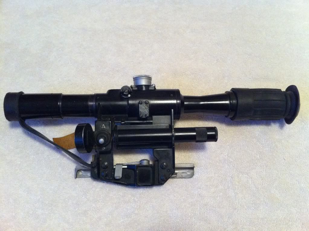

I have just received a PSL parts kit from Centerfire Systems and ponied up for the $99 scope with the kit. The scope that came with the kit is a L.P.S. 4x6 made in 1974 with the battery pack and I.R. detector.
Scope

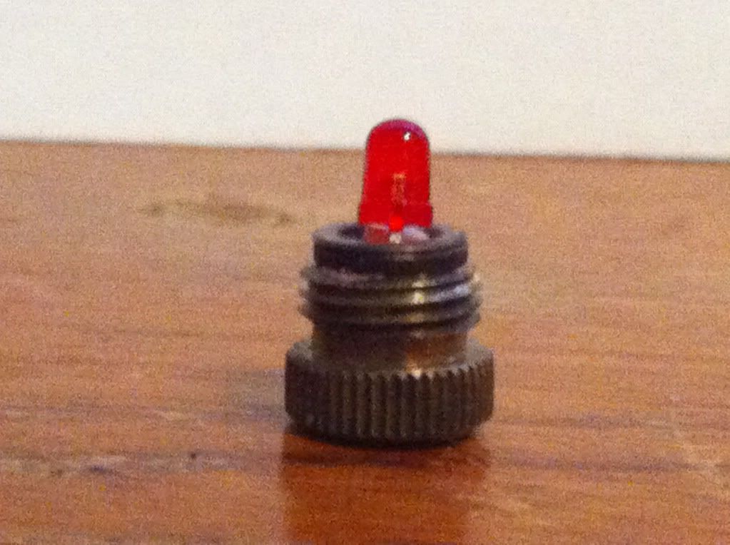

I popped in 2 AA batteries and found that the bulb for the lighted reticle was bad. I unsrewed the bulb holder, broke off the old bulb, and soldered in a high output red LED. I now have a nice red cross hair under low light.
Bulb holder with LED

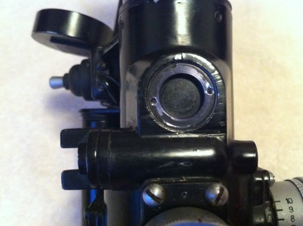

So to my issue. From what I understand, the I.R. detector should have CLEAR glass. Mine appears to be blacked out. I'm not sure if it has paint on it, or if the glass is just missing. I tried to remove the retaining ring so I could try to get a look inside, but the ring has been peened in place. I can't really seem to find any indepth info on this through Google so I'm hoping I can find someone here who can help. I know this feature is really worthless, but it would be nice if it worked.
I.R detector
also, if you happen to have a PSL with the serial number "C9518" This scope went with that rifle.
Scope
I.R detector
