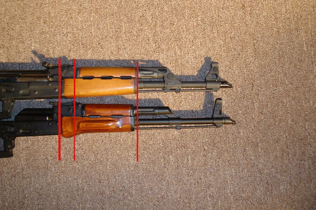

                    69Mach1
                    Super Moderator
                    • 15032
                    AKM vs Yugo
                    69Mach1
                    munkeeboi
                    TURBOELKY
                    antix2
                    WTSGDYBBR
                    tujungatoes
                    jmpgnr24K
                      69Mach1
                      Super Moderator
                      • 15032
                      The gas blocks appear to be in the same location, but it seems the Yugo gas port is a quarter of an inch further forward. It may work.
