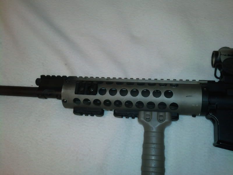

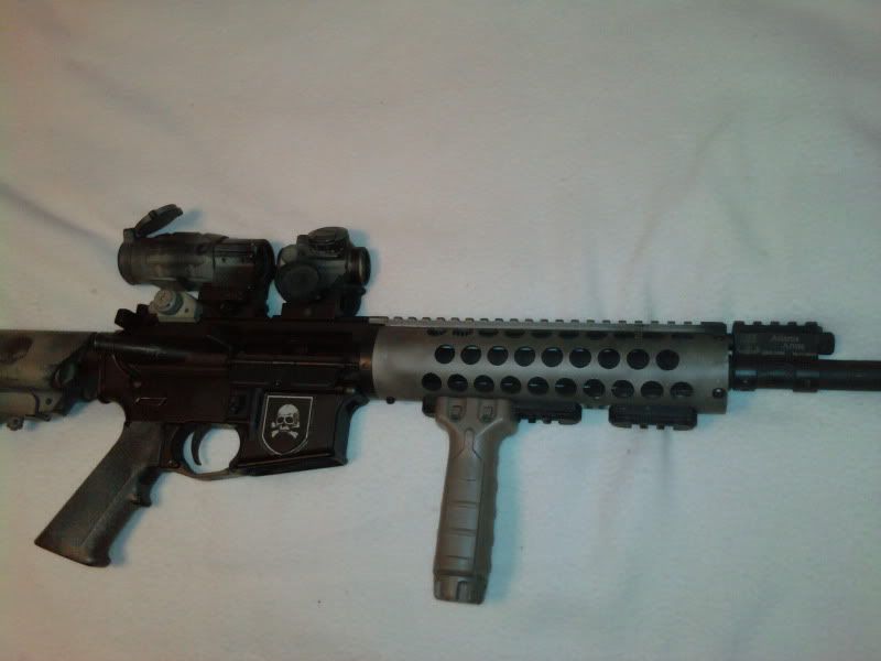

            I'm going with the Midwest Industries SS-Series Free Float carbine.
            Back in Dec. I built a AR pistol for a co worker using a YH free float.
            It turned out great but I have the above for my AR rifle in Mid-length and I like the feel and profile.
            Here is a pic.

              The pistol looks pretty good. Is that a 7 1/2 barrel? I might take the midwest free float off my carbine, put it on my new pistol, and get a YHM for my carbine.

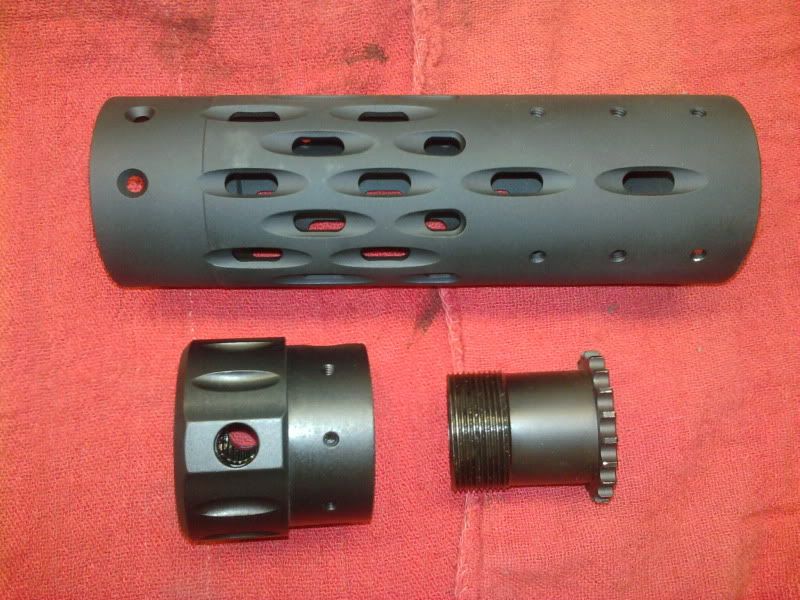

                      JD Machine Rail.. I bought this at the Del Mar gun show, and I'm going to return it and get their 7" Rail.. I didn't take into accouant that their barrel nut pushes the rail out further.

                          I got the 9" for $174.
                          I went over to JD today and exchanged it for the 7" that was $159 so I saved some money. The barrel nut pushed the 9" out to far for the look I want. Now with the 7" a A2 birdcage just pokes out a bit, I'll take a pic and post later.
                          I have their flyer from the gun show. If ya want I can post other length prices as well. (and NO I do not Work for them)
                          The rail will fit 308s as well the only difference is the barrel and timming nut.

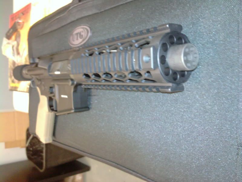

                              Here is the new 7"

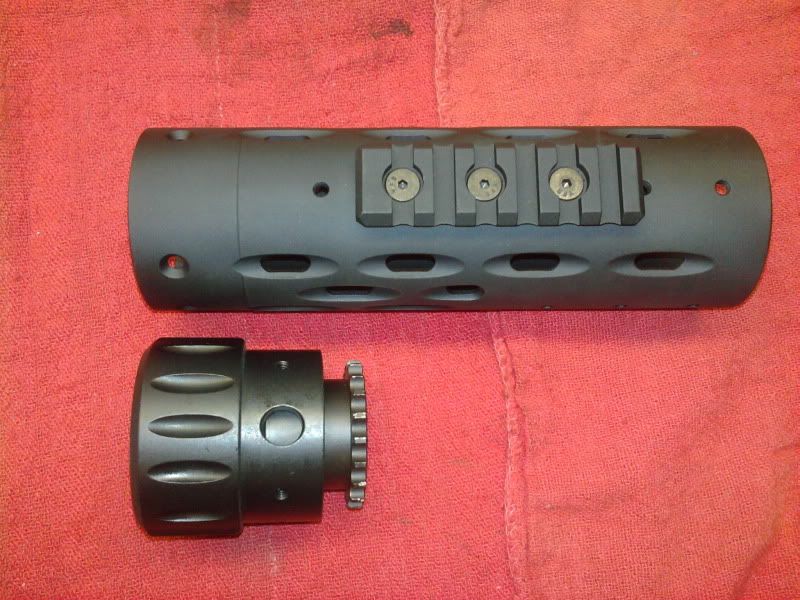

                              View of attachable rail.
                              Barrel nut Timing nut with rail

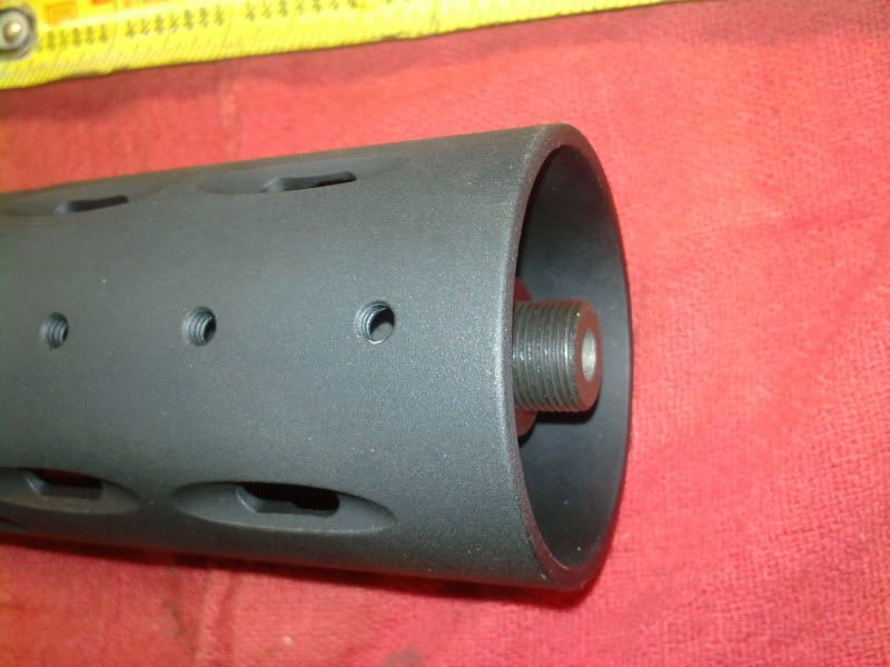

                              View of barrel
