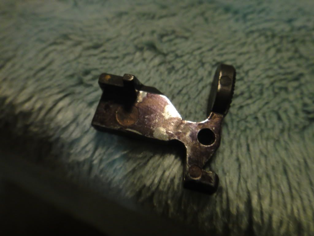

        Here's the bolt catch after all the filing fun. The exposed metal was covered with sharpie and set into the receiver to help expose the faulty areas:
        -GS
          jamesob
          • 4821
          The lowers are machined in 2 steps in that area and are often not perfect. Look at your lower and see if the machining has a step in it, if it does take a file and smooth it out.
