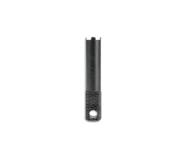

            But you will need these at some point:
            This barrel nut wrench is for your KMR barrel nut. This is for hobbyist install. This wrench also works for your M4 Castle Nut. 1/2" drive. Made in the USA.
            Shop armorer’s tools, cleaning kits, and lubricants to maintain firearm reliability, proper function, and prolong service life of parts.
            Square notches that engage the sight to give the operator precise sight adjustment. Knurled non slip handle with a lanyard hole for a lifetime of operation.
            Bravo Company USA, Inc is your source for the highest quality parts, & tactical accessories for your AR-15, M16, M4 Carbine
            Not necessarily from Bravo Company, although they are good to deal with.
