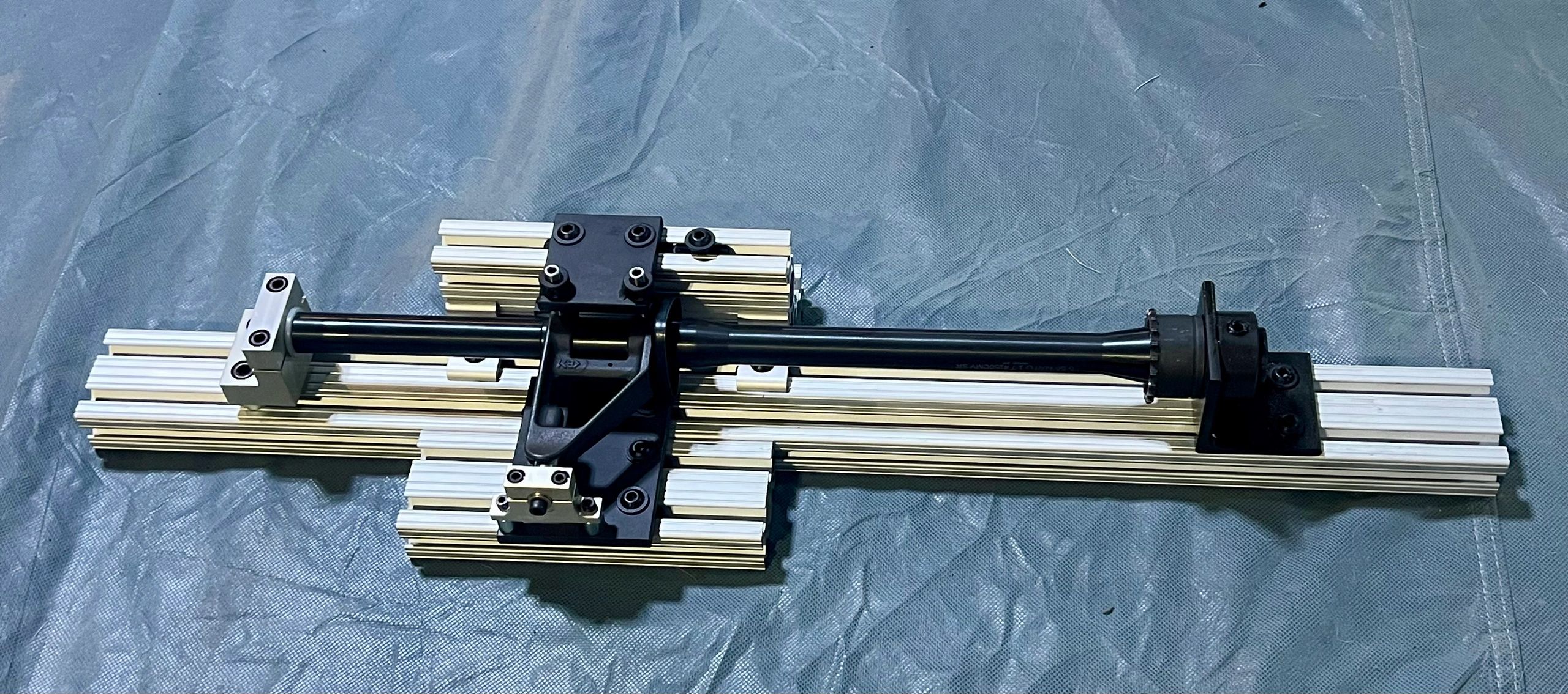

                      Found this:
                      EMAIL: BRDE@ENGINEER.COM JIGS ARE MADE TO ORDER PLEASE ALLOW 10-15 BUSINESS DAYS
