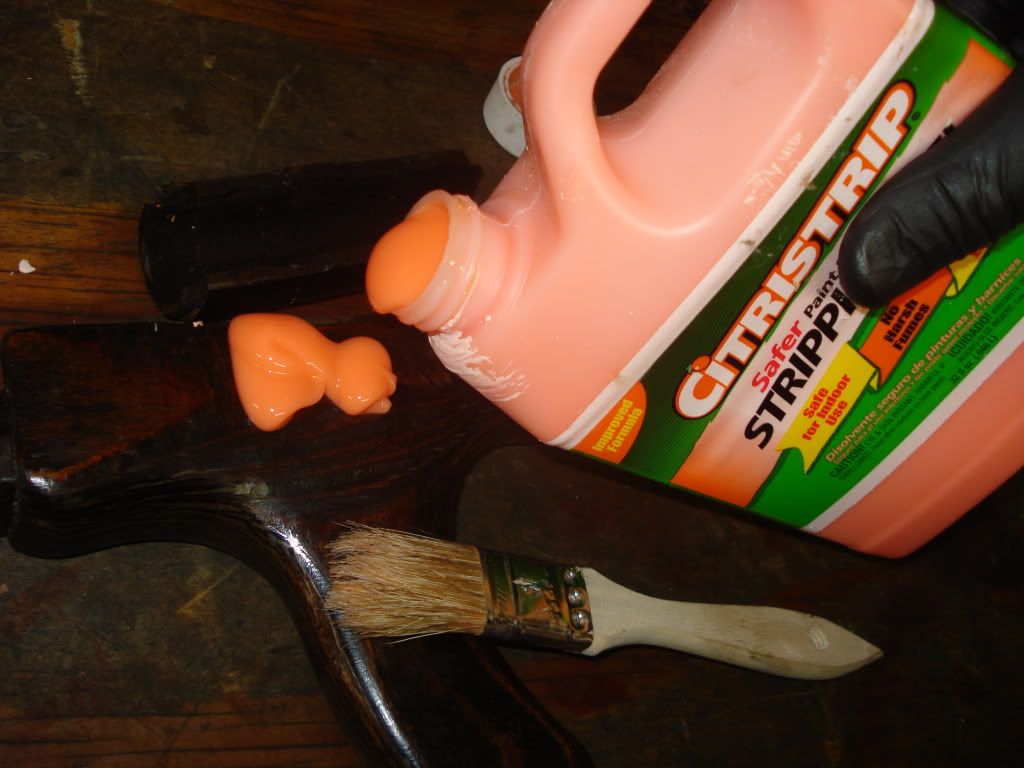

    Ok guys, this is my first ever tutorial I've done on anything, ever so I hope it turns out ok and you guys are able to use some of the info provided here. This is only my second stock that I've refinished, the first one came out so nice I wanted to share with everyone so here goes.

    It has been recomended by another member that you not use your wife or GF's toothbrush, do so at your own risk! Personally I like my wife when she's mad, it's kinda hot.

        After this 30-40 minute "soak period" I recommend scrubbing the entire surface with the toothbrush to loosen up and remove any remaining varnish that didn't come off the first time around. THEN rinse with HOT water as before and the stock should be completely clean.
        If you have any dents in the wood this is the point where you would steam them out. Steaming is a simple process, you will need a bucket of water, a nice, clean, cotton rag (I use the ones from Costco), and an iron. Just completely soak the rag in the water and then fold the rag in half so you have two layers and set it right over the dent, press the hot iron onto the rag and hold it there for 20 seconds or so. Check your progress and repeat as needed untill all dents are lifted out. Remember to keep the rag wet so it will steam every time and set the iron to the highest setting too. Allow to dry for 24 hours after this step before sanding. Here's some pics of the process.
