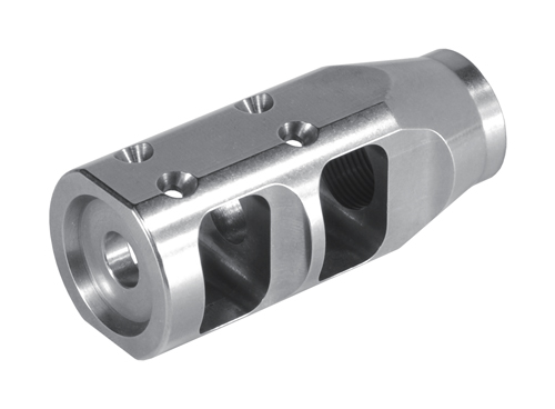

          I was thinking of a JP Enterprise tactical compensator. I guess I should buy it first and send it and the barrel to Randall. I think I also need a micrometer to measure the diameter of the bull barrel so it matches the compensator I order.
                  Your barrel should measure 0.920" forward of the gas block.
                  You will want the JP 5 series comp.
                  I would go with the 5/8-24 model simply because there's no good reason to thread for 1/2-28 when 5/8-24 is also an option.
                  This should be the one you want: http://www.jprifles.com/buy.php?item=JPTRE-5.58S.925
                  Send it along with the upper so I can index it to the barrel by machining rather than by shimming.

                    The 5/8-24 has a .350 exit hole, wouldn't he want the 1/2-28 with the .270 exit?

                      Turning down a bull .920 barrel down to thread 1/2"-28 isnt as good as 5/8"-24 Because of the extra metal that would have to be removed.
                      Also.. if you mess up threading 5/8"-24 you can always turn it down and thread it 1/2"-28
                      1/2"-28 is perfect for .750" barrels and is standard.

                        JP rifles... I can't figure out why they would not just leave the through bore small- so you could pick the caliber.
                          Bako
                          • Jan 2007
                          • 534
                          I called JP and discussed this thread. They advised against the 5/8 - 24 because of the bore issue. The tech I spoke with said the cutouts and the holes on top are designed specifically to work with the pressures released as the bullet goes through each hole of the caliber it was intended.
                          If you send a .223 bullet through a .308 hole, he said, there will be space around the bullet allowing gases to continue to move forward and diminish the effects of why you have the muzzle brake in the first place.
                          I will be ordering the 1/2 - 28 TPI because they don't sell the 5/8 variety in .223.
