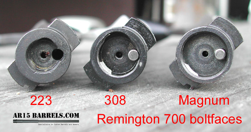

          Look for the guide rib notch in the old and new bolts.
          It's on the bottom of the right side lug when the bolt is installed in the receiver and you are behind the gun.
          It's on the bottom left hand side when you are looking at the boltface:
          All 3 of those pictured bolts have the guide rib notch.
          You can use a bolt with a guide rib notch in an action that does not have the guide rib.
          You just can not use a bolt without the notch in an action with the rib unless you make the notch cut into the bolt first.

            Thank you Randall, no notch on mine so looks like I'm good to go.
