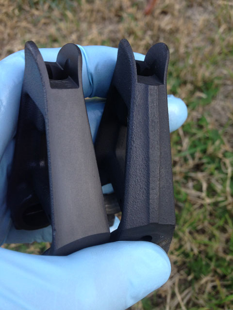

            Manganese without blackener pre-dip comes out really nice for what you are doing.
            The left one here is manganese without pre-blackener:
