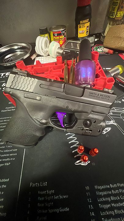

                    Well, it went really well. The set screw came out quite easily, no heat, no nothing. It had a small dab of red locktite on it.
                    Now, here is the real kicker. I wasn't even going to bother with the sight portions since I ordered a slide / red dot kit, but the sight was so loose I removed and reinstalled it with my thumbs!
                    The hardest part was reinstalling the sear block. I'll color fill the logo / lettering on the new slide with the purple nail polish in the photo.
                    Here she is, Apex Trigger, Hogue grip, TLR-6 Light / Laser combo:
