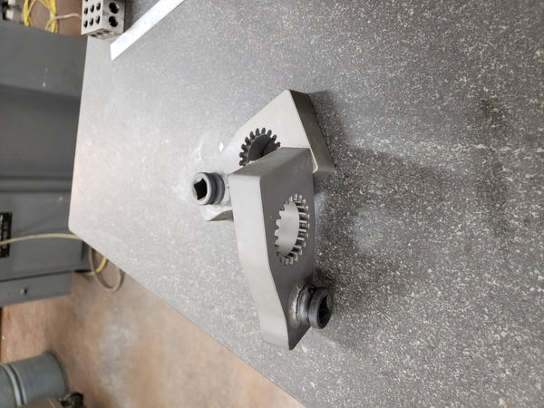

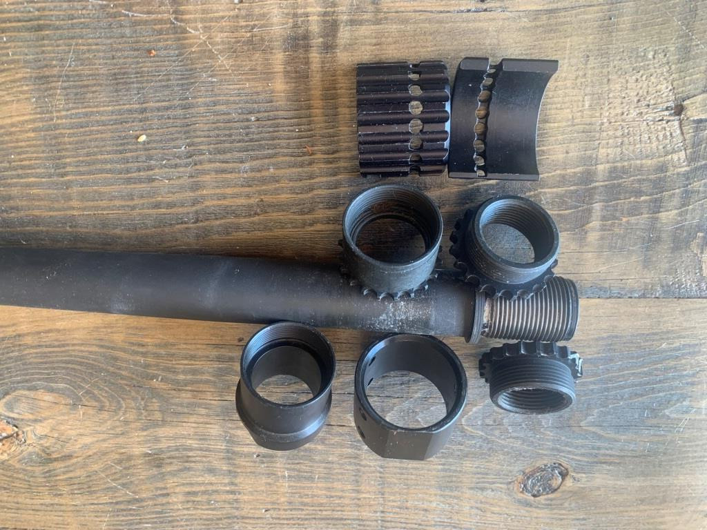

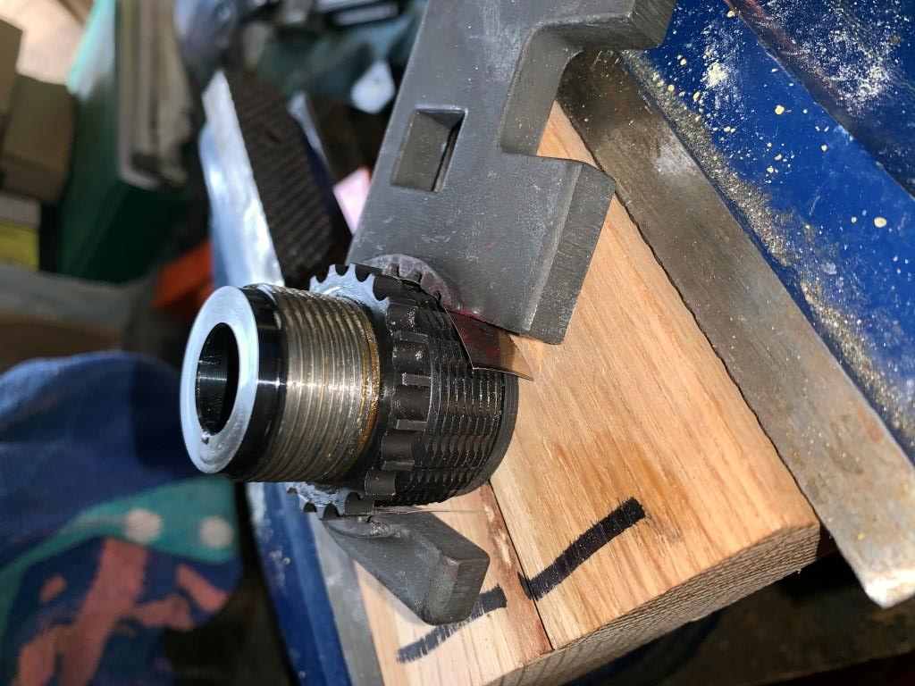

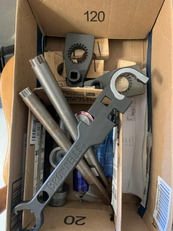

                              Can you recommend a action wrench to use.
                              I do have a gen1 and gen 2 . Gen 1 needs a new barrel.
                              I don't know if anyone makes an external action wrench for the RPR. I've seen video of schemes that try to use the slab sides in soft jaws but don't think that's a great idea. At least not for the factory barrel.
                              Anarchy Outdoors makes internal action wrenches for the RPRs but they shouldn't be used for removing the factory barrel. They do work well for setting up the headspace and tightening the barrel nut, but they're not completely necessary for that either. They call them Action Rods in their catalog.
                              If you want to swap out the barrel on your Rugar rifle, the search has ended. The Anarchy Outdoors branded rifle action rod, for the Ruger Precision and American Rifle models, has your back. This rod slips into the action providing overall support for those needed barrel changes, giving the home user the ability to swap the barrel with a standard bench vise.
                              I've had good luck with a barrel vise and AR barrel nut wrench for removing factory barrels.
                              This is the Brownells AR15 Armorer's Wrench after being modified to work with the RPR Magnum barrel nuts. The splines are the same size but the forend retaining nut threads are a larger OD than the short action. My idea of barrel vises has become simpler over the years. I use the AR wrench as a slugging wrench and pound on it with a 3# Engineers Hammer. The oak blocks have a coat of rosin on them.
                              Check out BROWNELLS AR-15 ARMORER'S WRENCH with 61 reviews and an overall rating of 3.7, available Online at Brownells Today and many more Wrenches products are available in our Tools & Cleaning Department.
                              The Brownells wrench worked without modification for the short action RPRS.
                              I've switched to the LRI wrenches.
                              LRI is proud to offer a professional armorers grade tool specific for the removal and replacement of factory barrels from the Ruger RPR, AR15 and Magnum Ruger RPR rifle platforms.  Elimination of sheared pins, ruined barrel nuts, broken tools, and loss of blood is the goal!  Features: Bar stock machined from billet ste
                              You're probably aware that Ruger won't sell the barrel nuts to the public. One side bears against the action and the Gen 2/3 forends stop against the other face. Any peening on either side of the nut is less than ideal.
