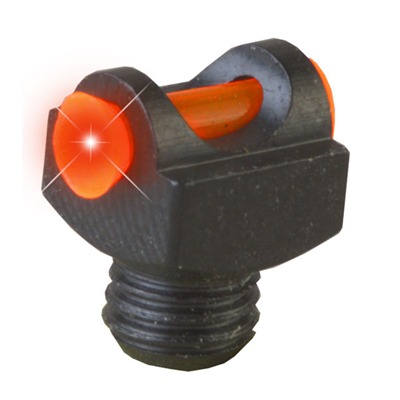

            Something very similar to this.
            Most likely threaded in. Probably a 3-56 thread. Possibly a 3-48 or 6-48. No matter, you're cutting new threads for the new sight.
            Do yourself a favor and determine its location on your barrel, and install the new one co-witnessed with the existing before you cut the barrel.
            Final install with 271 or 638 Loctite and kiss the stud inside the barrel with a dremel with a 1/2" sanding drum to make it flush with the bore.
