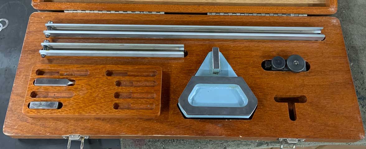

      Do you have a gage block accessory set like this?
      You can build any height you want and use it with the base on a surface plate as a very precise height gauge.
      The heavy block in the lower right corner is the base and any of the black gauge holders let you build a stack of gauges to a specific dimension.

          ar15barrels
          • 57088
          Originally posted by pacrat
          That's a nice set Randall.
          I wish I had that set.
          I don't though so I just grabbed a picture from google to explain what I was talking about.
          My set is an older Do-ALL which is missing most of the pointed and round blocks:
