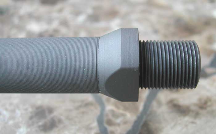

    Comments on this method from resident gunsmiths? I want to thread a Tikka t3x SuperLite.

    I have making threaded shoulders just like he is talking about for 20+ years but I don't do them on bolt guns very often.
    Tikka T3 lite barrels are usually 0.620" at the muzzle unless they are shorter than the typical ~23" length.
    I use 1/2-28 or 9/16-24 threads depending on the caliber of the barrel.
    Using threads at least 1/16" smaller than the barrel OD creates enough shoulder to tighten against.

        I have shortened and threaded skinny fluted barrels:
        That barrel was a professional ordinance carbon15 barrel which were very skinny.
