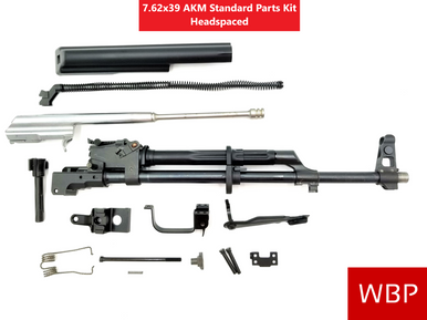

      On the Arms Of America website we believe in carrying the right parts. Like this AKM-47 Polish Parts kit. Come visit us today to expand your stock today!
      Thoughts? I got my receivers ordered.

        WBP is solid, I don’t have any experience with Kolarms yet though.
        Looking at the Kolarms kit, it is virgin, virgin as in waaaay virgin...
        I don’t see any holes marked, so there’s going to be extra effort to locate and drill the front trunnion holes, RSB hole, carrier/Piston rivet hole and the dreaded mag release installed... Mag release tab needs to be machined or filed down too. WBP would be an easier build overall, as it comes with all those things already done for you.
        Building on a Childers receiver is easy. Hardest part will be getting the rivet heads on the long rivets to look right. It takes some experience to get them to look right.
