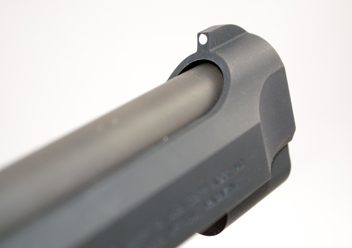

    I'm interested to know if anyone local (Monterey, bay area) can replace old worn tritium sights on Beretta 92. I think the issue is no one can ship tritium? So what about I bring the slide to you?? Anyone?
    hermosabeach
    • 19628
    Why can’t you mail sights to manufacture for replacement of the vials?
    It’s done all the time
    Or realize if you needed the glow over the past 10-15 years... do you really need night sights
    I’m not sure anyone is set up with a supply of radioactive vials and can remove the old and install new vials.
    Trijicon can take yours in and repair them. You need to remove from gun and reinstall
    Or find a shop that sells and installs sights and buy a new set.

      You're out of luck. Tritium is radioactive waste, so nobody at home is going to be able to comply with regulations for containment and disposal.
      You're also out of luck sending your slide to Trijicon to have the vials replaced. Trijicon charges $18 a piece to relamp dead vials on their pistol sights with new tritium vials. The bad news is that their newest policy is that they will no longer relamp sights if they are built into the slide, the sights have to be removable from the slide. On a 92FS, only the rear sights will come off, so Trijicon won't do it.
      When I had my Sig P232 night sights relamped by Trijicon, they had me ship them my entire slide via UPS. Got my slide back to me in 2 weeks. Before you ask, the front sight on a P232 only looks like it is built into the slide, it isn't, it comes off.
      Best option for a 92FS is to pick up a new Vertec slide. It fits and functions on the 92FS and both the front and rear sights have dovetails, so they are replaceable with night sights. You won't be able to purchase from Optics Planet if you live in California, they wouldn't ship a Vertec slide to California. That was 2 years ago, maybe they changed policy now?
      I found someone that had a new one and purchase it f2f, then installed a set of Trijicon night sights myself.
      One other night sight option, but not a good one, is to have a dovetail machined into your current slide. Most gunsmiths won't do it, since there isn't a lot of metal on the front sight area.

                        The front sight on the OP's Beretta 92 is not removable, so he WOULD be taking the whole slide.
                        If he could just drift out the sight, there would not be a reason for this whole thread.
                          The whole slide is just that, a slide. A slide is not a firearm. It doesn't matter if its a slide or a watch a jeweler can figure it out, it's not rocket science. The OP can do it with a small diameter drill, the kind with a hex base and just remove the existing tritium vial by hand. Then insert the replacement. Getting the vial isn't hard either, they get shipped to your front door.
                          He can't drift out the front sight so the OP's post is relevant. If we could all get primers, bullets, cases and powder quite a few threads wouldn't have a reason to exist either.

                            Aristocrat Products offers fiber optic sights for Beretta. The website also says they can remove tritium vials.
                              BrassCase
                              • Dec 2011
                              • 3191
                              You could also check with Wilson Combat, I believe that they will dovetail for a front sight on a 92FS.
