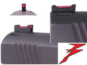

          google dawson sights they sell front and back about $70 depending if you want fiber. They give you the install tool and have video on how to install easy to do done it myself.
          Call and talk to them.

                You need to contact Armscor first, before buying sights. Armscor's "Novak" cut was not originally done to proper Novak dimensions. So, true Novak sights would not work. Several years ago, they change to proper Novak dimensions. So you need to contact Armscor with your serial number and see if your gun has proper sight dimensions.
                My gun is about 5 years old, and has proper Novak dimensions. I've changed the original black on black Novaks to white dot. It's not hard to do, but getting the rear sight out can be difficult. They seem to use some kind of glue to hold it in.

                  Looks like you need to replace fiber optic insert on front sight. Inserts are inexpensive and readily available. Rear sight is already adjustable. Buy a new insert and be done with it.

                      +1 Dawson, best in the sight business. See videos and decide for yourself.
