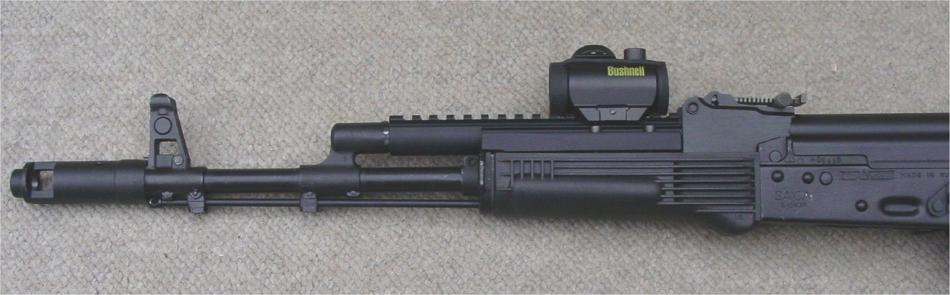

      Get a Bulgarian AK-74 FSB and do a "front end conversion" using a AK-74 type brake... It's the best option and will increase the value of your rifle...
      "Front end conversion" means removing the Saiga front sight base and gas block and replacing them with standard military pieces. That gives you the ability to use a standard AK-74 type muzzle brake and also gives you the bayonet / accessory lug on the bottom of the front sight base and gas block.
      Usually Bulgarian AK-74 parts are used.
      AR-15 barrels can do this for you... Or you can do it yourself...
      As in the pic below.
        Don't forget milling the handguard retainer notch or notches if the barrel does not have the side notches.
        Besides the pressing and drilling, milling the notches is the part that stops many people from being able to do it themselves.
