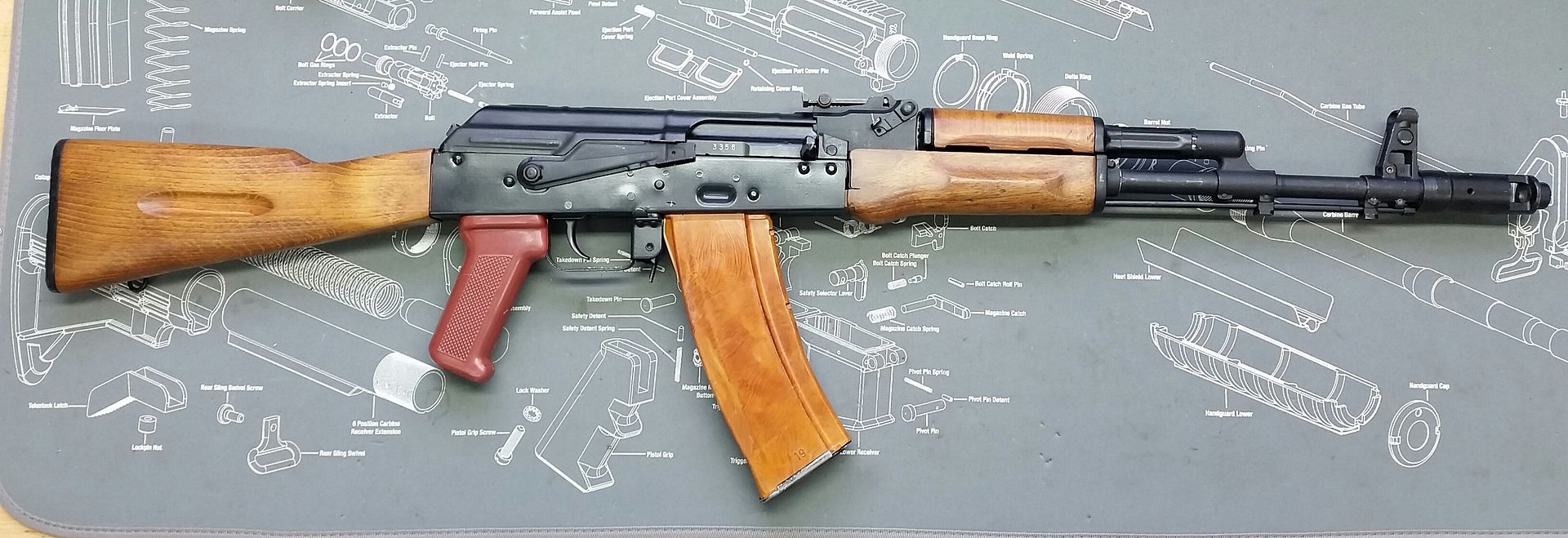

                    Originally posted by BigBronco
                    Home build's not worth the bending flats and having to serialize. I plan on buying a finished receiver. Moving all the parts that are compliant to the new one. I will of course go slow and careful. Got a friend who know the ins and outs but will wait to pester him
                    I forgot about that. I did mine a long time ago.

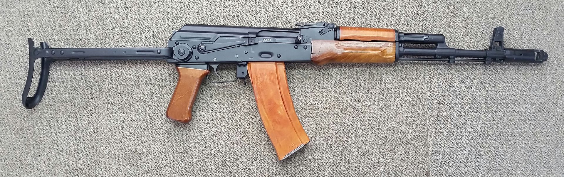

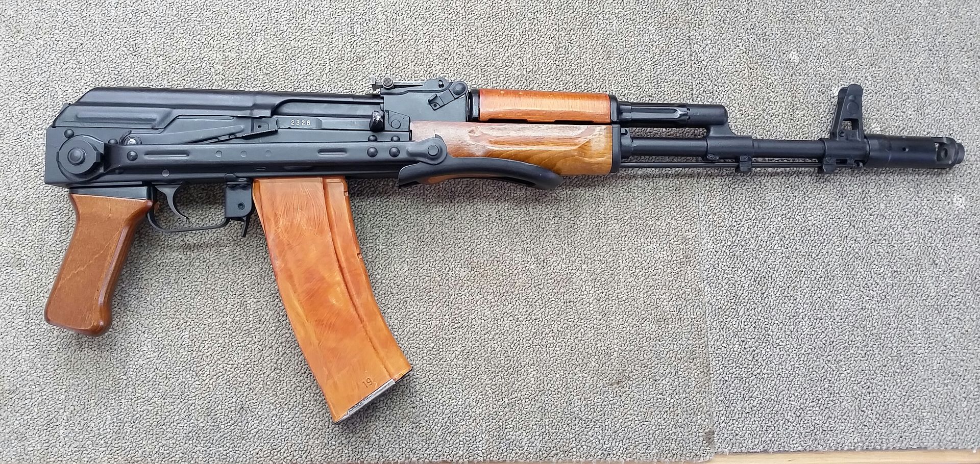

                      56Chevy
                      • Jul 2007
                      • 1872
                      I did an underfolder, but I had to cut the holes for the stock by hand.

                        BigBronco also not a Cabinetguy
                        • 7067
                        ^^^^ Please tell me about the CA Compliance factor of the muzzle device on the above picture? Is it a hider or a brake the parts I am getting has that on it?
                        "Life is a long song" Jethro Tull
                          69Mach1
                          Super Moderator
                          • 15032
                          Brake

                            SVT-40
                            • 12894

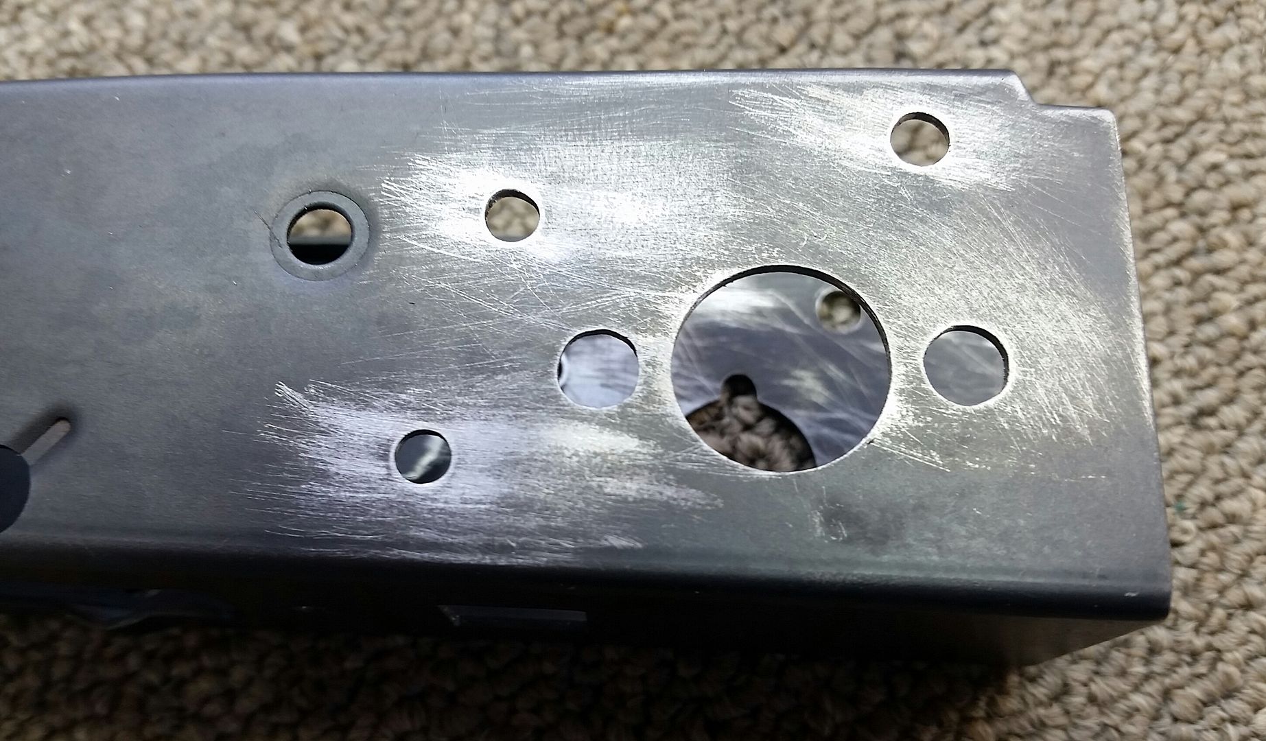

                            So did I. It really wasn't a big deal. The rear trunnion is a good guide. Just drilled the receiver holes close to the trunnion when it was in held in place temporarily, then used a Dremel to finish to the final sizes.
                            I used a Polish under folder stock and parts.
                            Before
                            After.
                            Poke'm with a stick!
                              56Chevy
                              • Jul 2007
                              • 1872
                              Thanks for the pictures. I was wondering if I was doing it the hard way...I guess not. By the way, great job!
                              Before
                              After.
