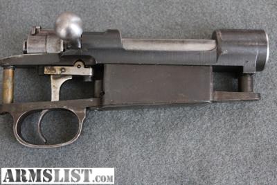

    Mauser 98 has a fixed lug and controlled feed, but no extractor cut in the barrel because the reciever has the extractor clearance:
      Except for those pesky "safety breech" Yugo 98s.
          Hence they are not a standard 98...
