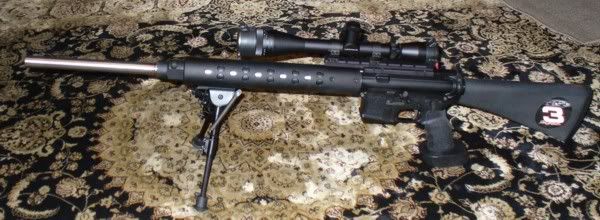

                I got my 1-12" 24" SS barrel from Compass Lake...
                            Thanks for the Tip, I like their offerings. Nice gun.
                            My bolt guns are heavy, 26" barrel, 15 lbs without a scope.
                            So I am looking for a lighter package. Any idea what your setup weighs?
                            Is a 24" barrel the sweet spot in the semi world for 36-50 gr. bullets or would 20" work just as well?
