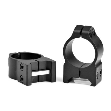

    Looks like a recoil lug that fell out of a scope ring, guessing it might be a Warne it fell out of.

      Is that a barrel lug that fits inside a stock?

            If the rings were vertically split, which Warne's are, it can very easily fall out. I have several Warne's in service.

              Yep that sounds like it. Looks like the uncoated metal part on the base of these rings:
              These Maxima Fixed 201M scope rings from Warne Scope Mounts offer excellent performance at an economical price.

                The lugs are removable, that's why they are so easy to misplace. A lot of shooters only run the lug on one ring, so the other one may never have been there to begin with.

                  Warne scope ring lug.
                  They fall out when the rings are split apart.
