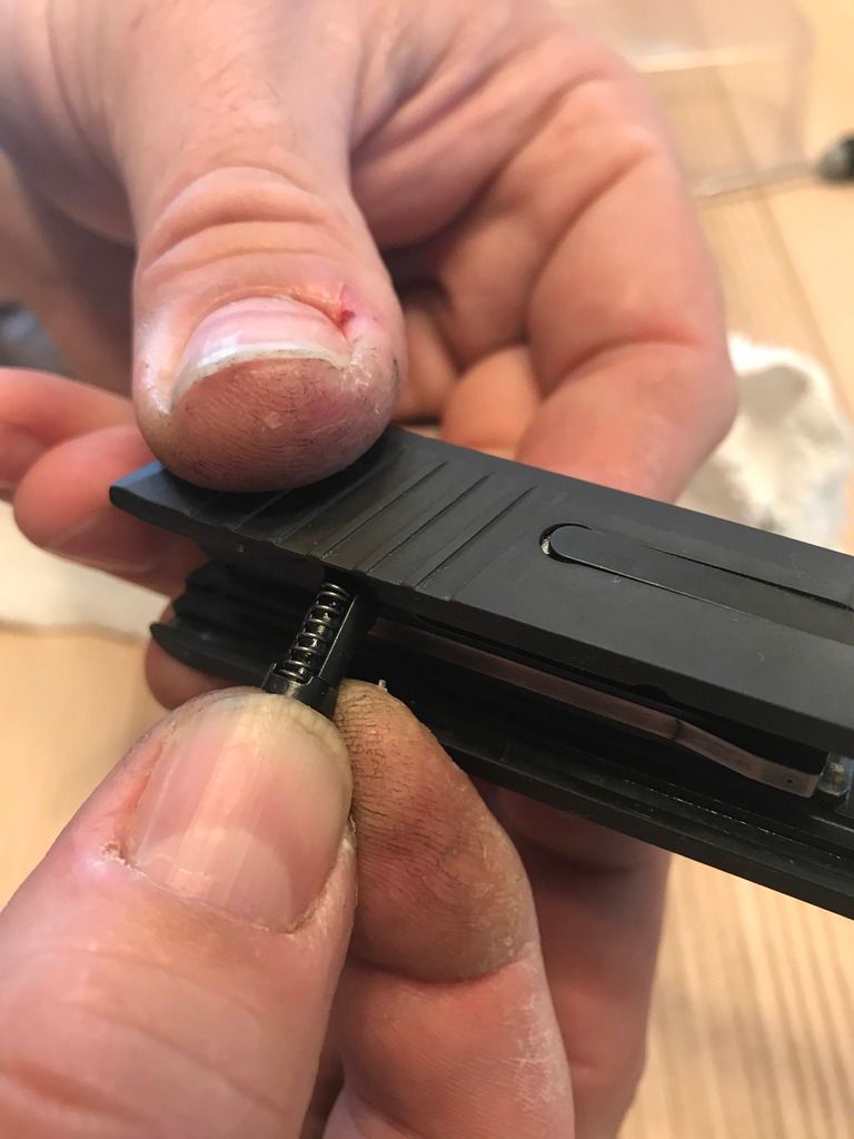

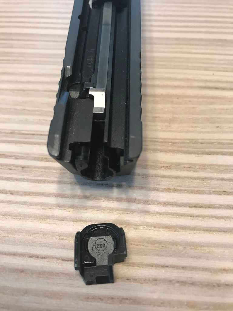

    On the left side find the rear plate detent. Using a small flat blades screwdriver push toward the front sight as use use your thumb with your other hand to push the rear plate away from the rear sight.

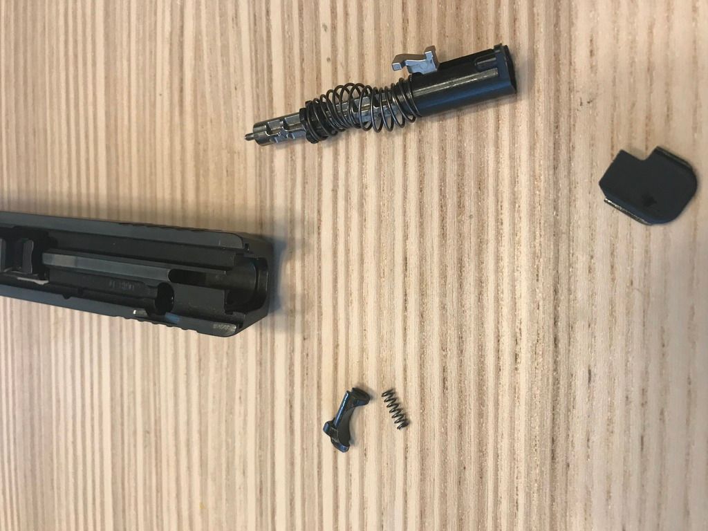

    Push down on the fire pin detent found along the left side of the slide and remove the striker assembly

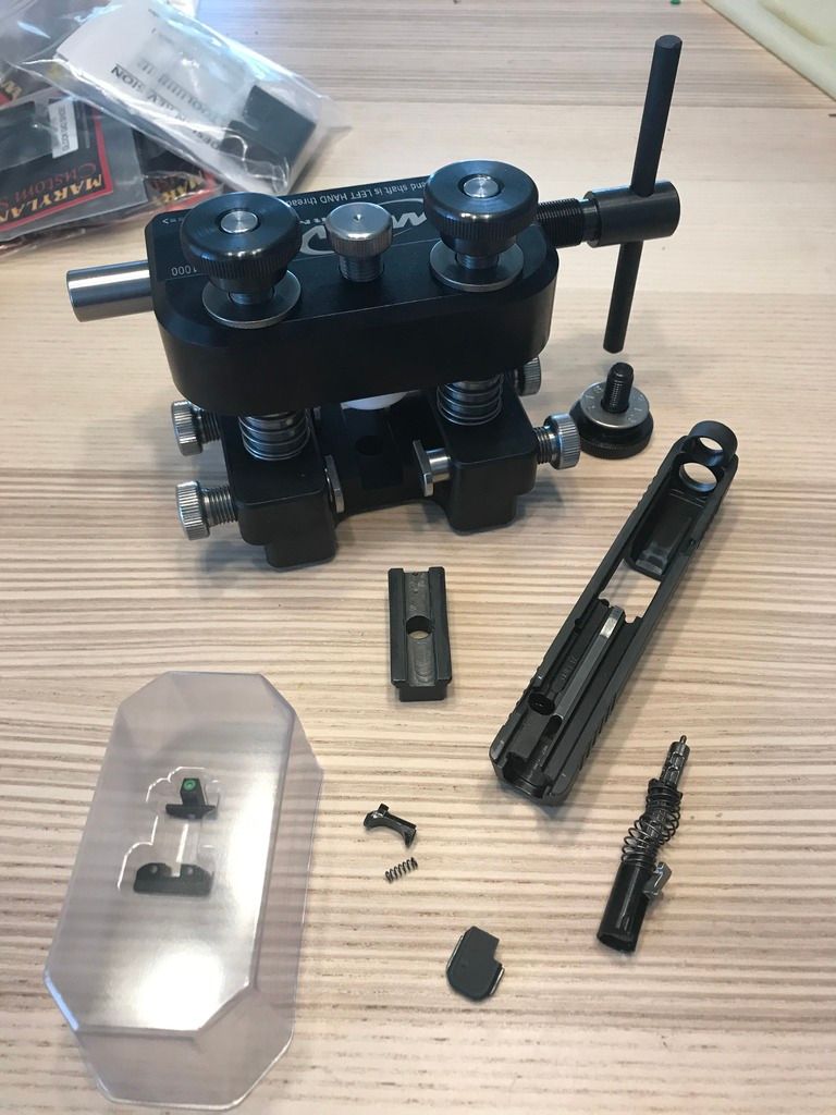

    Gather up your sight pro sight pusher and new sights
    I had to modify a sight pro shoe #105. The width was narrowed from .7400” to . 7300” and a channel was milled in the middle to a depth of .1300
    Press your old sights out.
    Press In your new sights.

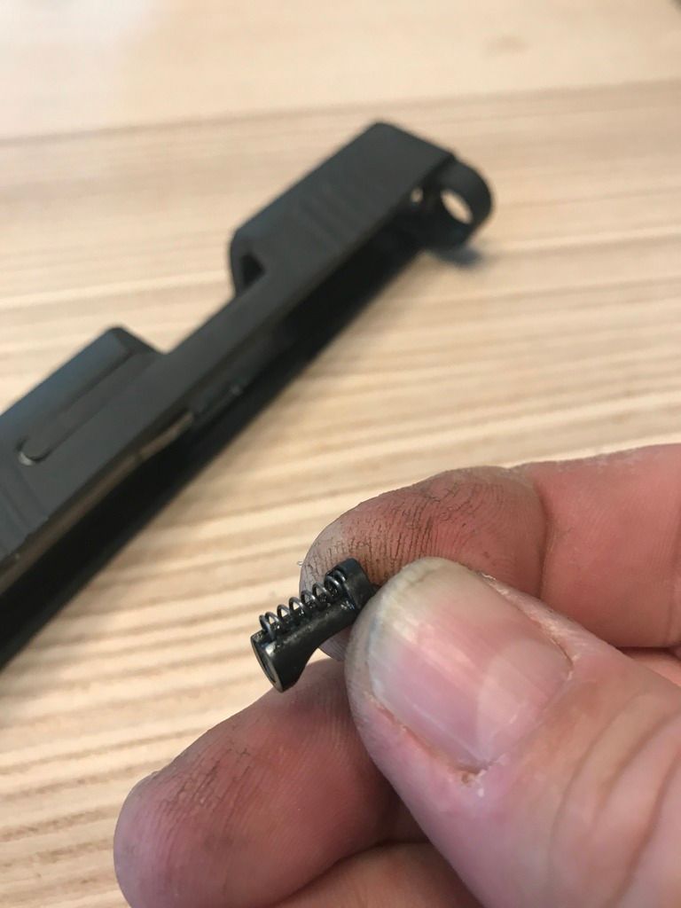

    Start with the striker assembly detent. There is a machined ledge that the small spring rests on.
    Push in on the detent as you replace the striker assembly

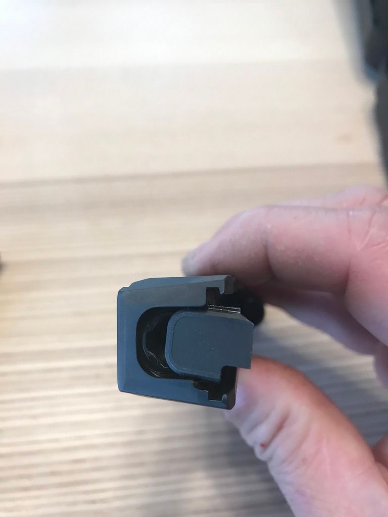

    Use your index finger to push in on the striker assembly as you place the rear plate into position
    When it’s set into the channels push it toward the rear sight until you hear a click.
