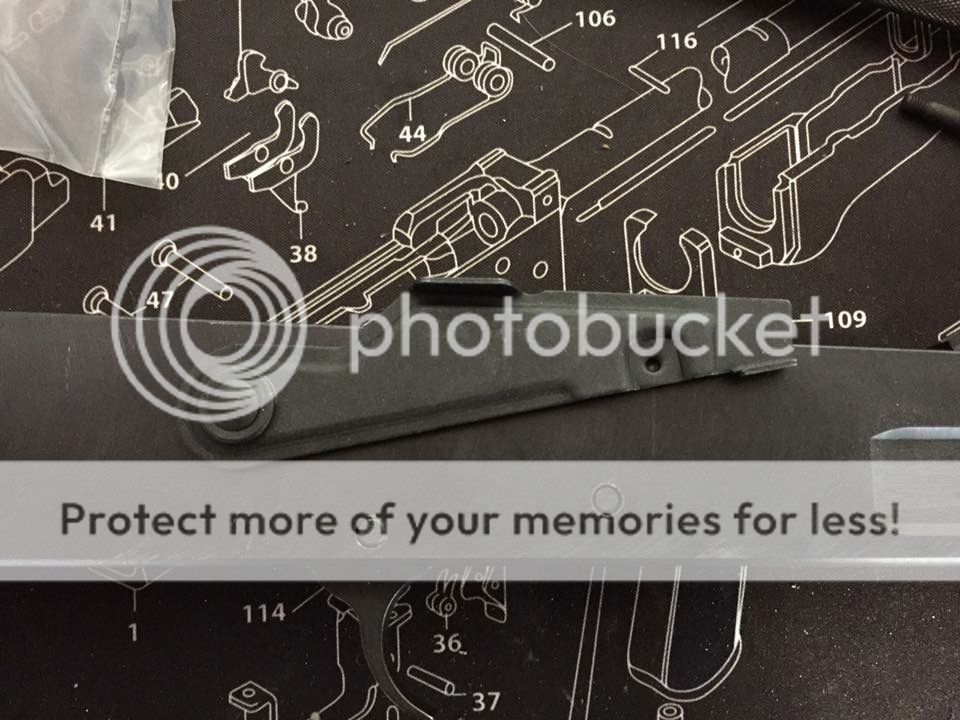

    Milled yugo m72 fixed stock receiver from tortort with a m70 underfolder kit from Apex. Here are some pics of the build so far.
    Kit and receiver as shipped.
    Web cut to start filing to shape the ejector. Cut with dremmel

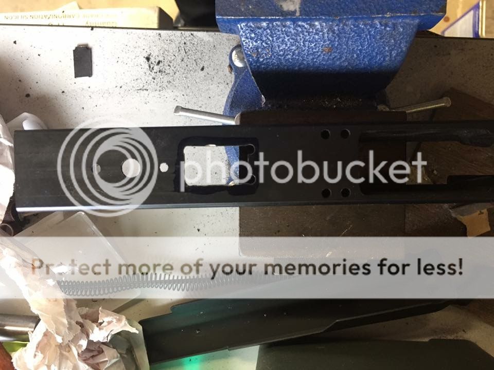

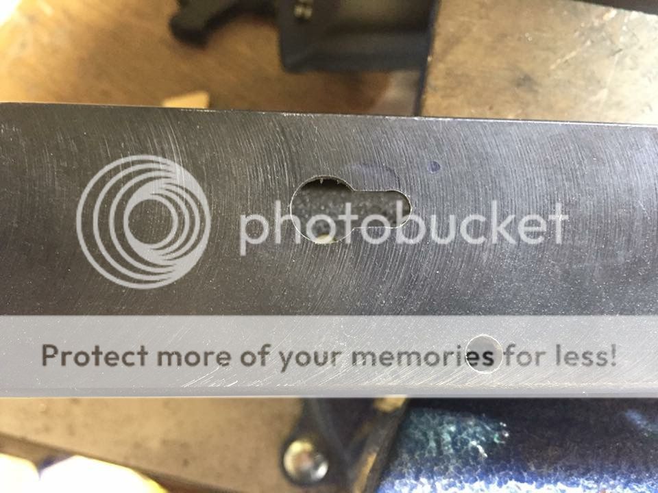

    Trigger slot marked and ready for drilling/cutting. I'm using a double hook G2 trigger (3 922r parts). Used a 80 flat to mark the trigger slot outline.
    Used a 5/32 drill to drill the four corners. Then cut with dremmel wheel and filed to fit the trigger.
    Then used the ak builder drilling fixture to drill the trigger, hammer and safety holes. Taped up the center support hole as it's not used on a milled receiver. Also had to push out the pin on the jig as milled receivers done have the divet there. Used some punches to align jig using the trigger guard river holes that are also drilled out on jig. Filed the two safety holes and blended them together.
    Trigger, hammer and safety fit and function checks out.
