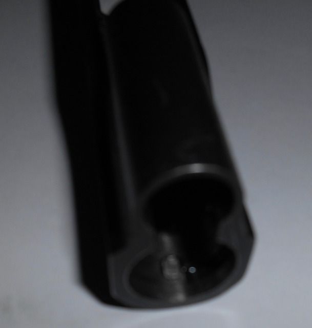

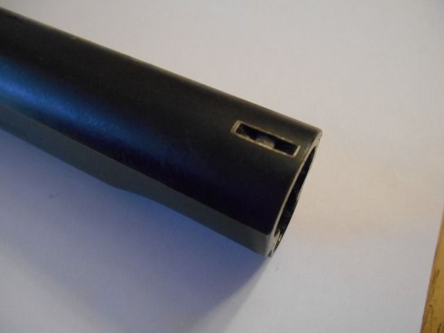

    Went shooting today and took a springfield 1911 with me. I think Mil-spec model. Anyway the front sight sheared off so Im looking for options. I'm thinking of an upgrade to fiber optic sights. I do have the ability to cut the slide for said sights.
    Anyone have a good print for front and rear Novak sight cuts.
    Also I'm not sure what Sight hight to get. The stock sights seemed to be the correct hight.
    One more thing. There is still part of the front sight in the slide. Looks like I need to push it out from the top??

    If just the leg is remaining, you should be able to drive it out toward the inside of the slide.

            Sure thing. Did you get the leg out?
            Hobbies: bla, bla, bla... Bought a Mosin Nagant... Guns, Guns, Guns...
              NotEnoughGuns
              • 999
              I'll do it when a get to machining the sight cuts.
