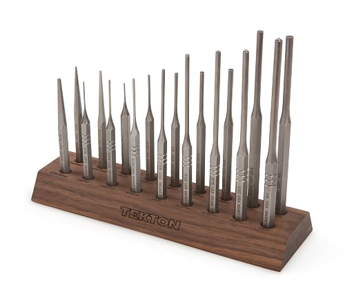

                  Been eyeballing this one. American made, heat treated etc. ~ $50
                  TEKTON 66564 Gunsmith Punch Set, 18-Piece
                  Also have just the roll pin punches ~$30, here: https://amzn.com/B012TKY0UE

                        I bought a couple of Tekton punches on Amazon to try them out. I won't make that mistake twice. They are too soft to be useful, neither made it through a single work day. I work on ARs of every description on a daily basis and they are cheap crap IMO.
