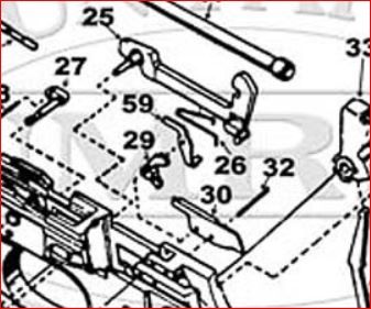

    And after cleaning my beretta 92fs,I notice when I test the
    functionality of the SA and DA dry firing, the SA only works,
    And I notice a small piece like a paper clip fell off.
    Please help Beretta Pro's over here in calguns
    I have a picture of the piece of metal that fell off

    That is what pushes up on the trigger link so you can cock the hammer in double action. On the right side in the rear.
