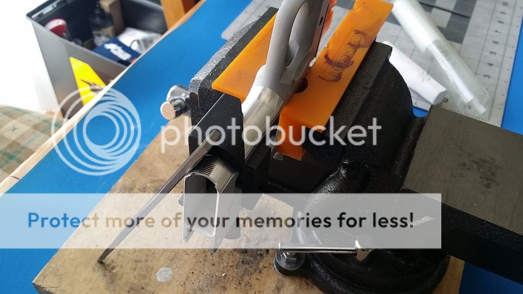

    Sanding down the high spots on the front strap. It is actually very even with no noticeable high spots with the exception of what looked to be a flat spot in the middle of the front strap (cast line?).

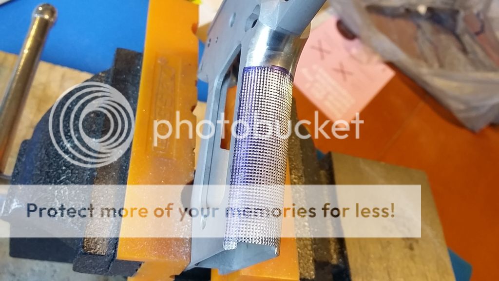

    Setting up the jig to cut the first horizontal lines. I aligned the lines to the magazine lip cutout in the bottom of the frame.

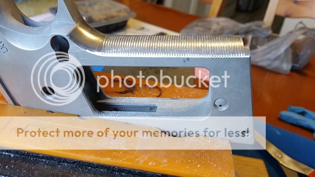

    Laid out all the horizontal lines; just needed to deepen them a bit. It is recommended that you cut each set of lines to the depth the checkering file will allow, so you have good lines to follow when cutting the next lines.

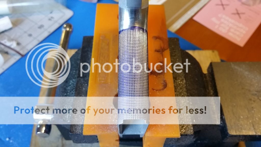

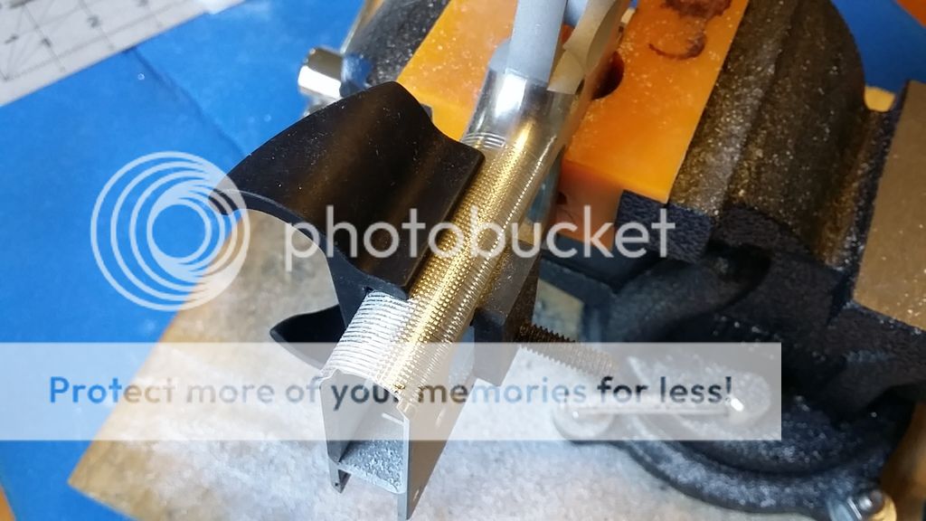

    Setting up the jig to cut the first vertical lines.
    After removing the jig, I used Dykem on the front strap to see the lines I'm cutting.

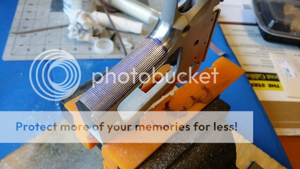

    Finished cutting all the guide lines. Next comes the tedious and hard work; cutting all lines to equal depth and pointing up the diamonds.

                    After my recent 1911 build, where I had quite a bit of "on the job" training with filing, this first part of the checkering job was easier than my mind made it to be. That and I read so many posts where people swore they would never checker again due to the difficulty and effort required, I really thought it would be harder than it turned out to be. Then again, the next part is the harder part so I hope I can do it.

                        If you notice from my second picture, the one showing the jig set up for horizontal line cutting, the jig wraps around the circumference of the front strap. That helps a lot because you have a guide as you cut across the frame. Some jigs, like the brownells one, does not follow the curvature so you have to be sure your file does not wander on the second half of the cut. It helps also that this Power Custom's jig is the cheapest jig, that I could find anyway.

                              When pointing up, be patient and take your time. Stay straight and don't get in a hurry. It don't take much to screw it up and yes the points take a awhile. It will look terrible for a bit, but when the points come is a real nice feeling.
                              I haven't done a frame yet but have practiced on a pipe. First one was a bit rough, haha
