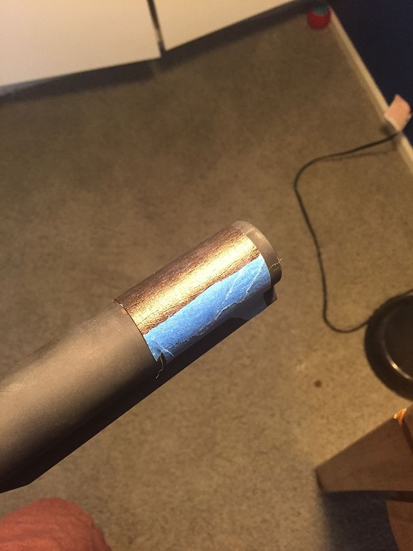

    Now that the receiver wobble is solved the second wobble I had on my rifle was from the but stock. I was surprised (as this is my first build) because I did not go cheap on my buttstock. I am currently running the Rock River Arms Operator Car stock and buffer tube combo, so I though that the product would have zero play. Anyways, to avoid this rattle in the first place try investing in a stock that has anti rattle features such as the Magpul stock with the vacuum thingy. If you are like me and you already have a stock that, beside from the rattle, is amazing...then listen up!
    This fix was free for me seeing as I already had the supplies I would need in my garage. I also have never seen anyone else do this. What you will need is a roll of tape (I used 2inch blue painters tape) and also a sharpie (unnecessary but I like to be tidy with my work).
    -Take the buttstock off of the buffer tube
    -Layer on a couple 2 inch long sections of tape
    -Install buttstock
    Repeat this process until you feel resistance while adjusting the buttstock. For me i only used like 4 pieces of tape until the rattle went away. Make sure you don't block the holes underneath the buffer tube, if you do you buttstock wont lock in place (common sense). My buttstock has a hole on the top which allowed the blue painters tape to show through so I used the black sharpie to color ad section of the tape completely black so no one can tell that the tape is there.
    (Side note on this fix... you might be able to use a form of duct tape. Either way if SHTF now you have a couple pieces of tape to use in a survival situation.)
    Now wobble your rifle! It should now be silent! Let me know if you have any questions or if there are any other fixes that we should add to this list! Hope this helped!
