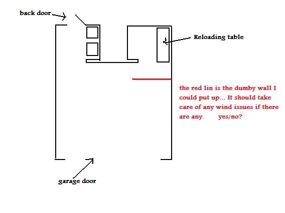

    I recently began building my reloading area in the garage an picked a cut-a-way area that looks like a big closet in order to reduce wind flow when the garage is open. I have also heard in other threads in regards to reloading scales to try and control the climate however my garage is not insulated so it magnifies the temps outside (it feels like it anyway). If someone could elaborate on this I would appreciate it. Not sure if I should store the scale in the house?? Does the stable climate only apply to when it is in use?? Does climate apply to any of my other reloading equipment or supplies?

        I have both scales...(dillons) If wind is the main problem I can build a dumby wall. Will the wind effect the mechanical scale in the same way? or can I use the mech scale as a control until I know the conditions are good for reloading with the electronic?

              Both types of scales will have diminished accuracy if there is more than a slight breeze. Given that the scale(s) are used to adjust/verify your powder measure, anything that'll keep the wind off will do. One of those 3-fold room dividers, or perhaps a small cabinet, whatever... The newer electronic powder measures have an enclosed area for the powder pan. The thing that causes me the most trouble in my garage is the freezer plugged into the same electrical circuit. My scale weighs differently if the freezer kicks on.
