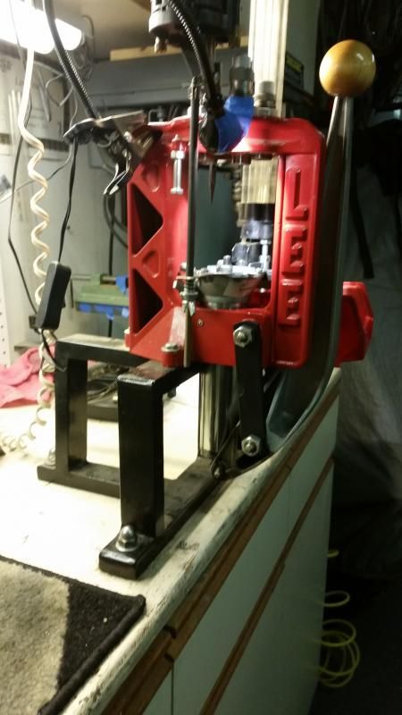

            Here is a picture of my set up. I think it is pretty well mounted solid. haha
            Another pic

              It takes that kind of mount for a LM to work. I built my riser out of 3/4" plywood. Went out and got the shellplate and some small and large primer brass, large barely clears the edge of the plate as it's being installed. Small is centered and has an equal gap around the primer to plate. I would look and measure the gap between the small primer and the plate openings. Fact you get 20% failure and this is a five hole plate, seems likely one of the five is out and the rest OK.
              I always ask how much time on a LM, it tends to be a first progressive press with a progressive newbie trying to figure it out; a lot of which don't have the mechanical aptitude to use it. You do.

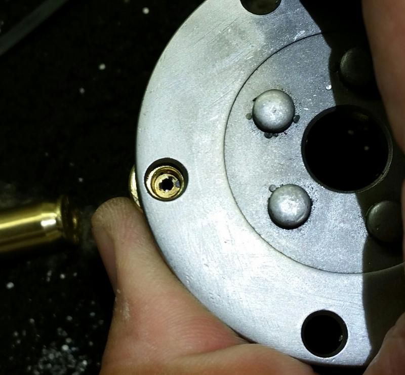

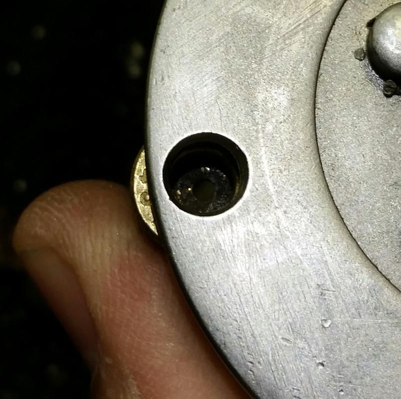

                  They say a picture is worth a thousand words... And here lies the problem!
                  This picture shows a .45 ACP case with SP
                  Another picture closer up
                  This picture shows a .45 ACP case with LP

                    You have a parallax issue with the photos; you're shooting from an angle and it makes the primer look off center. You have to have the lenses directly above the hole, so it's straight down into the primer. When you look down into the hole, is the small primer off center in all 5 stations?
                    How old is that shell plate? All the LM plates I have the hole extended out the edge, so it's a groove instead of just a round hole. My plates are from 1995 to 2012, and all the same groove.
