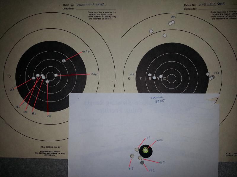

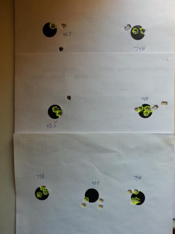

                I shoot both Speer TNT125 and the Varmint 130grs out of my Rem700 .308 because it's economical and I have a lot of it (since I got bored of my 300blk AR and it's more fun to play with reloading recipes)
                The loading is very similar between the two projectile.
                To reach the lands with the Varmint130 in MY GUN, bullet must be seated at 2.80". For TNT125 bullet must be seated at 2.948" which is not possible because it's so short, so I seat it at 2.80".
                This will give you an idea how it shoots with different powders and grains. Did this all in 1 session...every bullet and grouping was labeled, every bullet was individually weighed/reweighed, every component down to the primer was matched to 0.1gr. Neck tension is set at 0.002. (LC08 machine gunned brass, WLRP) I should be able to shoot but who knows.
                I'm inclined to try 49.2gr Varget again as it might've been a dud on my end. Plus the primer was barely starting to lose it's round. so I want to go higher just to see when the pressure really comes on.
                Also, that is a Benchmark ladder even though it looks like a horrible group. I really wanted to get this powder to work for TNT125/130, but it just refuses.
                I had all the targets up and I alternated targets and loads each shot. Benchmark vs W748. I was fighting some wind on this one, but I didn't make any scope adjustments.
