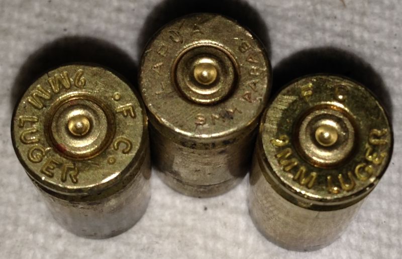

    is this overpressure ? 9mm
    I have a Berreta 92FS and when it was new I had lots of feeding issues, FTF, stovepipes, etc.
    I worked up a load that was 100% reliable by doing 20 rounds at a time going up in .1gr increments from 3.9, ended up at 4.3gr. of HP-38/Win231 with a 124gr. plated bullet, COL 1.150, very reliable and good shooting round. Winchester small pistol primer, range brass.
    As I learned more about the gun AND reloading I started shooting the gun wet (before I was using minimal oil) and lowering my charge because of what you see in the primers, I think its overpressured. I am now down to 4.0gr and those rounds are from the 4.0gr. load, the primers are still bulging out some. I think that is overpressure right ? It has not really changed from using 4.3gr. to 4.0gr. it looks pretty much the same. With 4.0gr.'s of powder my brass is getting pretty dirty each shot, something that did not happen with 4.3gr.s. that implies to me I am not sealing well and I did try annealing some brass to no change.
    I am going to try increasing my COL a little bit this weekend and also go to another tenth down on powder but my book (and the Hodgon website) says 3.9 is min and 4.4 is max. I have double checked my pretty old beam 5-0-5 RCBS scale with a Hornady cheapie digital scale so I know my drops are pretty accurate.

    Mike, I don't believe those primer strikes are indicating over pressure. Reading primers is very unreliable. The primer edges don't look flattened at all. You are right to stay within published data and be aware of COAL and powder charge. Measuring case head expansion might give you a better indication.

        Do factory loads have that same bulge around the firing pin strike? If so, most likely the primer is flowing into the firing pin hole and for some guns its normal.
          One can anneal the neck to keep the neck from splitting.
          The primer pocket is not something that one needs not wants softened by annealing.
          Normally straight wall pistol cases do not need to be a sales from my experience.
          I so not know if the .40 recoil spring is market differently that the 9mm spring in the beretta platform. While it is unlikely that you have the stiffer .40 cal spring in your pistol, you might check to verify that the spring is correct.
          From the pictures, I don't see a problem with the primers.
          If you had primers come out, check the brass. Was it once fired military brass with tight pockets that were swaged open?

              look at your slide around the firing pin hole I believe that you should have a matching recess on it - I had the same thing showing up in some of my 45 colt loads & it drove me crazy because I new I was nowhere near being over pressure...

                These are normal primers out of a Beretta. If you look at the firing pin hole in the breech face you'll see a corresponding dish.

                  That is no where near over pressure. It is well within safe limits.
                  As a reference, my Quickload program shows you can use 5.3 grains of 231/HP38 with a 125 grain bullet @ 1.150 OAL.

                    Those primers are fine.

                      Thanks everyone, I never thought to look at the breech face and you guys are right there is a matching groove there that the primers are flowing into. I will re-increase my load a little as its getting pretty dirty with the lower load. I feel kind of dumb for not having checked the breech.
