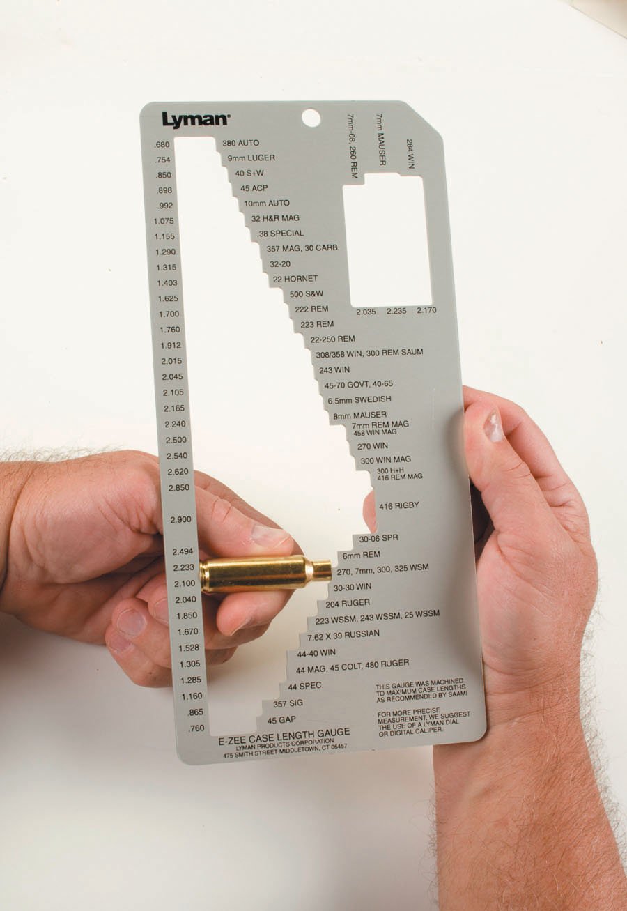

                You could get one of THESE, and then just check and trim when necessary.

                  That's cool, looks like I'll be picking one of those up lol

                    23's Dad
                    • Jun 2010
                    • 502
                    Look at the lower right corner of that Lyman Gauge.
                    You need a caliper anyway.

                        Witch Hunter
                        • Oct 2013
                        • 174
                        If you have a caliper, the gauge is unnecessary....

                          Personally, I prefer case gauges for each caliber I reload. For example, the .308 gauge will show you if your case is within OAL spec, whether is it properly re-sized and if it is head spaced properly.
                          The Lyman length gauge above is pretty nifty and handy, but I still prefer machined steel case gauges. Just picked on up for .30 carbine, which is my next reloading project.
                          I check every single case before and after resizing. Funny thing is every single .308 needs "work", while nearly all .223 would be fine to reload "as-is".
