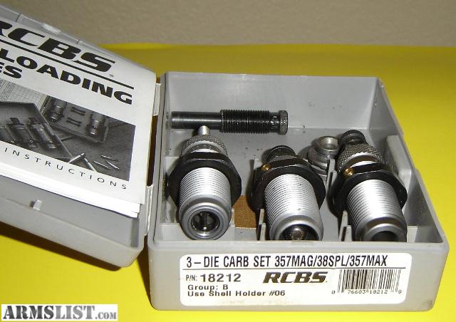

                  heck, my RCBS set does 357 max too. It is not labeled as a 357 max die set either:
                  its bigger than either 357 mag or 38 special, too.
                  I suspect there are very few die sets that can only do 38 special, but not 357 mag.

                      jeez, not rocket science:
                      Whatever you want. This'll do it.
