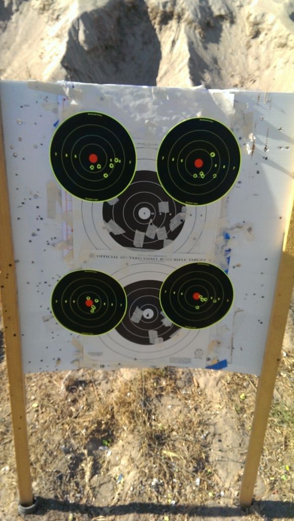

          The last target I was just screwing around with my last set of reloads(25.0gr H335/CCI400/LC brass/Hornady 55gr FMJBT) and shot 20 rounds to warm up the barrel prior to shooting my Z-max loads. Just for size factor, the red bullseye on these targets is the size of a penny. They are the small 8" stick on targets.
          One thing I have noticed now is that as much as I love reloading, and as much as I prefer shooting bulk loads, I am really getting into accuracy. I love to be challenged and I am considering seeing what I can do with some match loads...lol Onto the pics.....Seems the best groups were 23.5 and 24.5
          From top left of 22.5 to bottom left of 24.0

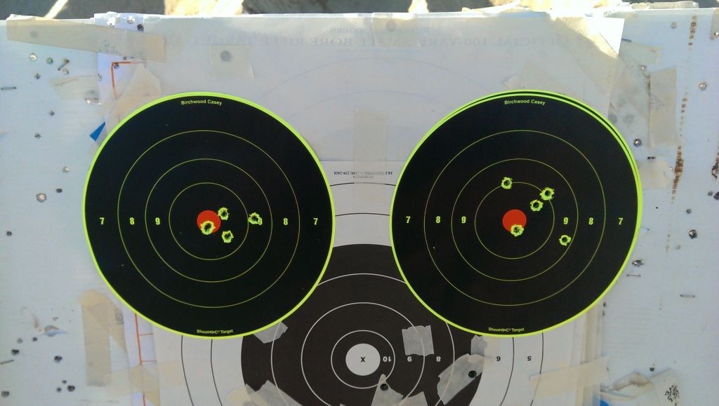

          Top left of 24.5(two in bullseye) and top right of 25.0

              That scope is more than adequate, at least as far as magnification goes. Your technique needs work to shrink the groups, however. Are you shooting off a bench in a rest, prone with a sling, or what?

                Also curious what you were using for testing… bench with rest, bipod, rear bag…
                Looks like your 55gr FMJBT load was shooting just as well if not better than the z-max.
                So there is some room for improvement for that Z-Max load, or some improvement on your technique.
