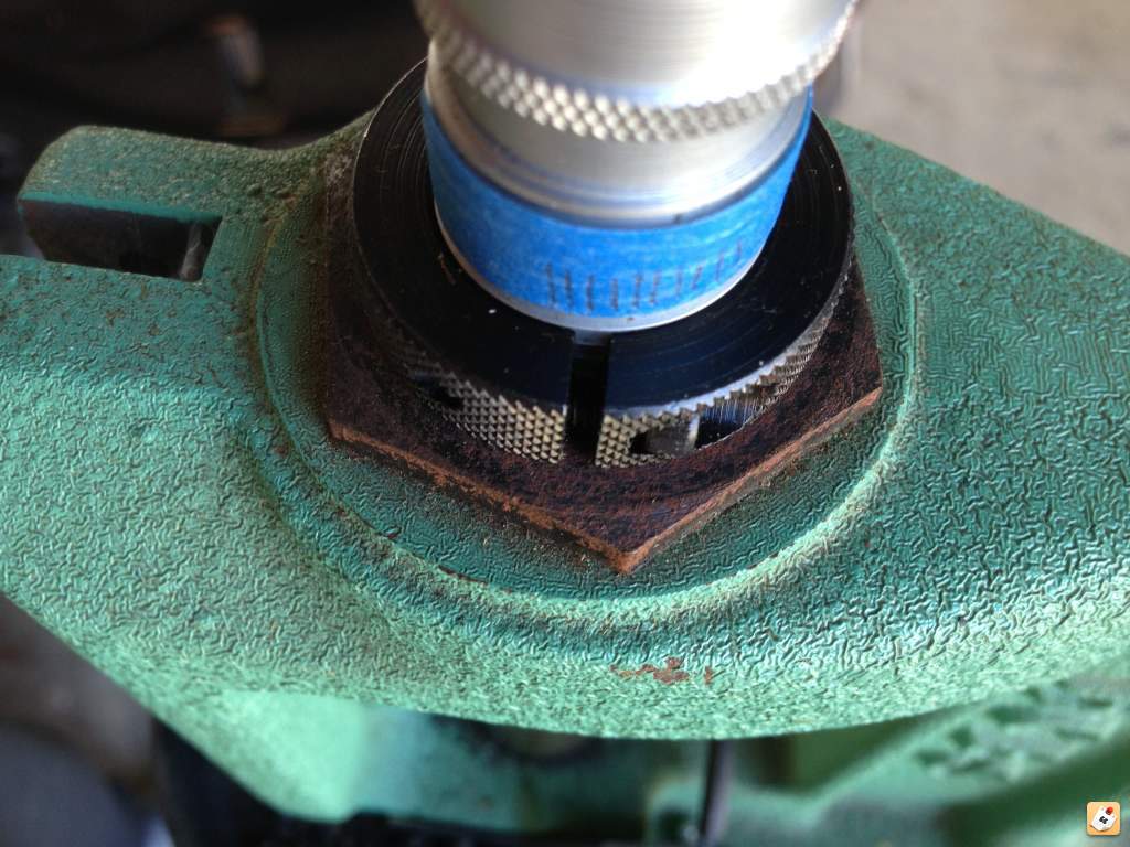

              If 3/4 of the rounds will fit, it probably only needs to go down 0.002" more for them ALL to fit properly.
              Wrap some tape around the threads if the die and make hash marks every 1mm.
              Then, turn the lock ring on the die body until it passes 2 hash marks.
              Each hash mark will give you 0.001" of die adjustment up/down.
