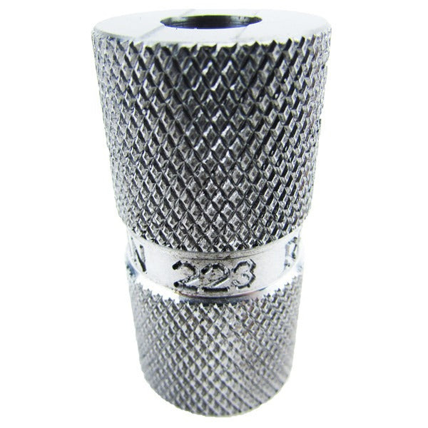

                    whats a case length gauge?? I have never seen one nor used one and probably never will...

                      its one of these, basically you drop your case in it, and if it fits it is the right size (length and width)
                      To achieve the highest degree of safety and accuracy, inspect all bottleneck rifle cases to ensure that the proper headspace dimension is maintained. The best way to check this critical dimension is with a Lyman case length/headspace gauge. The reloader simply inserts the case into the gauge to insure that it does not
                      I have an RCBS small base size die, which is about .002 smaller than the normal 223 resizing dies, and does a great job of prepping brass for AR15s which seem to be notorious for being "tight"
