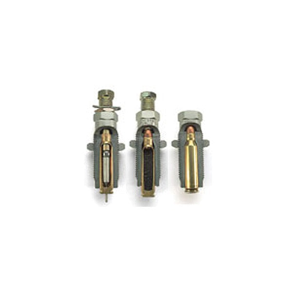

    hi, im new to reloading I got a rl550b for a gift and was missing the .223 rifle three piece die set, I called Dillon but they are out of stock for up 3-4 months. I want to no is there any other three piece die kit that would work in the Dillon press ? thank you.

    Any standard die set will work. Id buy anything you can find right now, .223 dies seem to be out of stock everywhere.

            5 in stock at Grafs.com for dillon dies. Sounds like you are new to reloading and I suggest getting Full Length dies for reloading rifle and buy a reloading manual. Heres the link for the dillon 223 FL dies.
            Dillon Three-Die Rifle Die Sets include a sizing/ depriming die, a bullet seating die and a taper crimp die. Dillon Sizing/Depriming Die The sizing/depriming die is full-length, to minimum tolerances, sizing cases down to function in semi- and full-automatic firearms. We strongly suggest that a headspace case gage be u
