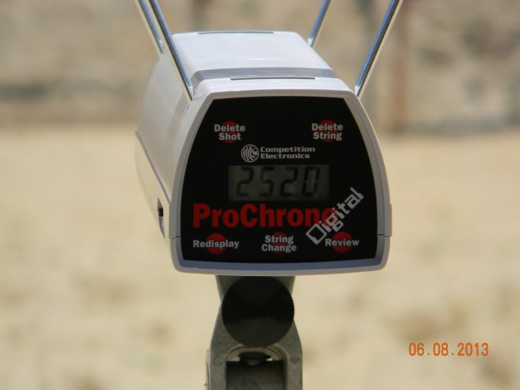

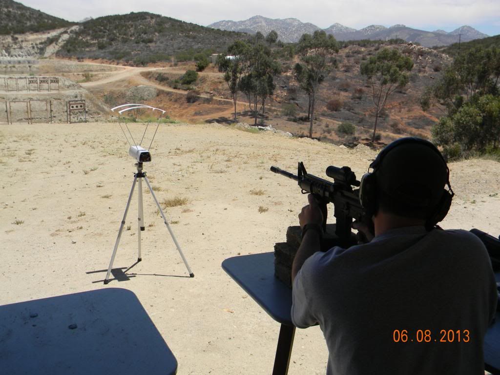

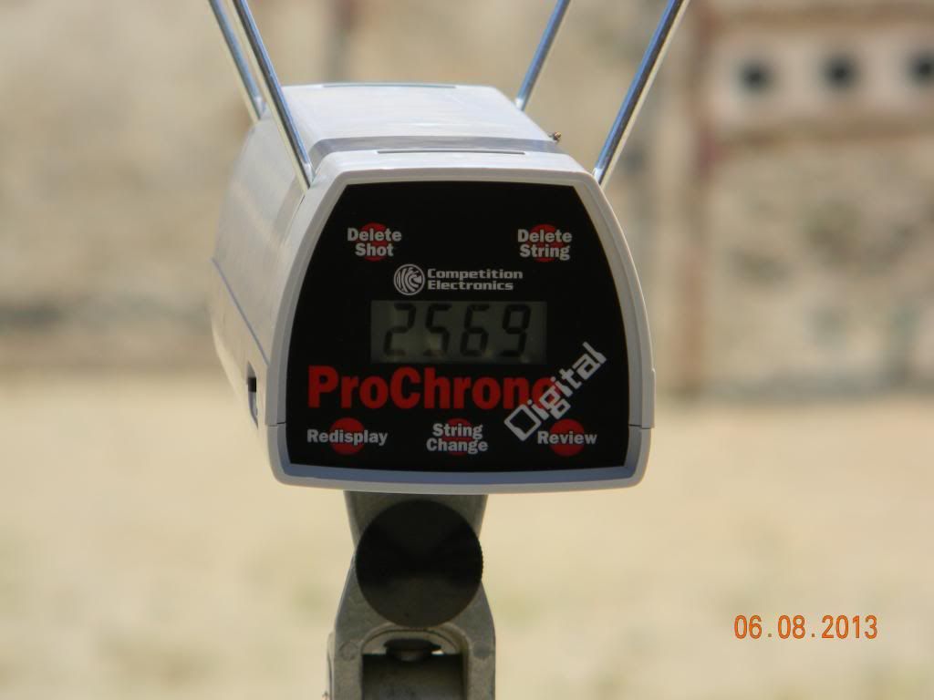

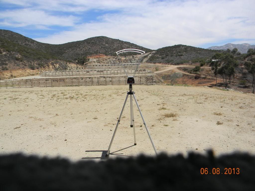

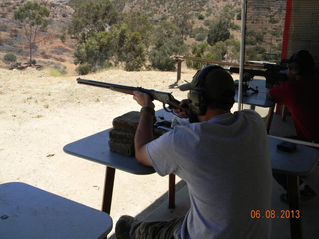

              Well went to the range today. You could not wipe the smile of my face from that Winchester 92' 25-20wcf. Man that is a sweet gun, recoil is basically zero. With such a small round and a heavy gun it basically feels like a .22mag. I don't have all the chrono log with me, but it was running around 1,300 fps. The rifling still does a good job and putting a spin on the little .25. I was 1" high @ 1 o'clock @ 100 yards. All I have left to say is you have to shoot this little guy to understand.
              As far as the chrono, it was a well spent $99. It did not miss one shot in bright day light. Only down side was not being able to change strings due to the fact that walking out on a hot range might not end well. But I will be purchasing the $50 cord and software. From first impressions, if you need a chrono, do not hesitate.
