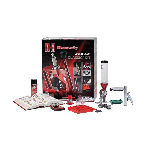

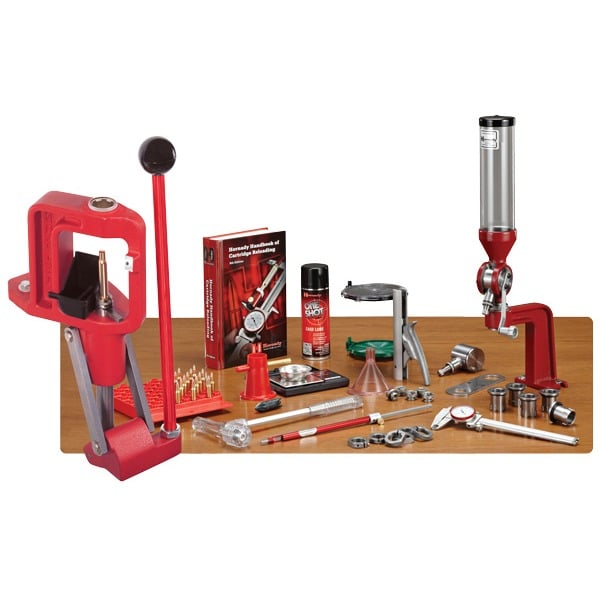

          You will want a tumber, I would instead skip the turret press, get a tumbler and single stage press with quick change bushings instead if that's an option. Cleaning brass sucks so you will want to automate this step, cleaner brass means cleaner less problematic dies. You can skip the primer pocket cleaner and get a more useful "primer pocket uniformer". Just get a small base die later if you size your brass and still have case/glock buldge.
          Look into a hornady kit, and compare the cost to the Lee if you include the 500 free hornady bullets and other extras you get for buying their kit. I picked 500 185gr XTP hollowpoints for my 500 free bullets.
          The Lock-N-Load Classic Kit Deluxe represents the most complete single stage reloading package Hornady offers. Includes: Lock-N-Load Classic single stage press Lock-N-Load Powder Measure Digital Scale Hornady Handbook of Cartridge Reloading Three Lock-N-Load Die Bushings Primer Catcher Positive Priming System Handheld Priming Tool Universal Reloading Block Chamfering and Deburing Tool Powder Trickler and Funnel One Shot Case Lube Die Bushing 3 Pack Sure-Loc Lock Ring 6 Pack Powder Measure Stand Shellholder Pack 1,2,5,16,35 Kinetic Bullet Puller Lock-N-Load OAL Gauge Straight Vintage Tin Sign Pistol Rotor & Metering Assembly Steel Dial Caliper FREE Vintage Tin Sign included with purchase »
          or cheaper:
          Just getting started in hand loading?  There's no need to search for equipment or worry about what you're missing when you get this kit.  It comes with everything you need to turn out high-quality, accurate handloads, right from the start. Kit includes: Lock-N-Load® Classic™ Reloading Handbook Lock-N-Load® Powder Measure Digital Scale Lock-N-Load® Die Bushings (3) Primer Catcher Positive Priming™ System Handheld Priming Tool Universal Reloading Block Chamfer & Deburr Tool Powder Trickler Powder Funnel One Shot® Case Lube
          the delux comes with alot of the little things your buying though, like the calipers, bullet puller, digital scale, case lube (not the cleaner though). The Positive Priming System is the priming system for the press, it beats using the hand tool for sure but can be bought separately. I started with the cheaper kit myself. It's not really anymore than the Lee Turret once you figure in the free bullets. I'd personaly rather have a single stage than a turret press, then upgrade to a progressive later, and then you can still use the quick change bushings.
          You may also need shell holders. And may also want : primer flip tray and a powder trickler. They are cheap tools to make the task easier.
          You can get a cheap digital caliper on amazon for about $14 a dial caliper will cost more.
          I don't know what a lock stud is so you can probably go without that?
          If you do wash and scrub each piece of brass make sure you rinse them very well. No need for the oven this time of year, I always dry mine in the sun (Stainless media tumbler).
          I would suggest starting with a powder that will fill the case more than 1/2 way, that way you will spill powder all over the place instead of loading a double charge. Longshot (also a shotgun powder) will work pretty good for this and I know it works for 40sw.
          Oh get a can or two of hornady one shot CLEANER, you will want this to remove the oily anti-rust residue from your new dies and powder dropper. Its good to have to clean your dies, I can't live without it

            This is just my opinion but this advice is about as bad as it gets.
            First, he bought a Lee Turret.
            Second, a tumbler is not a necessity. Wiping cases in a damp towel is all the is "required"
            Third, he is loading for 40S&W, so even if he had not already made a choice, a single stage press is not his best choice (possibly the most debatable of all the issues at hand).
            Fourth what is he going to use a trickler for? He is loading 40S&W.
            Fifth, ditto on the primer pocket uniformer? For what? Uniforming his 40S&W pockets?
            It is confusing enough starting out, getting this kind of advice is counter productive.
