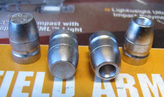

do not go to http://castboolits.gunloads.com/ you will start joining group buys for pretty mold blocks like this:
That make bullets like this:

That one on the left has some strange frosting or crystallizing on top.. I wonder which alloy he is using?
