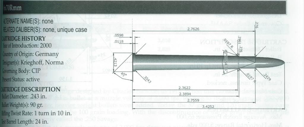

              Try These
              Food for Thought
              Caliber.......................Case Length.....Bullet Diameter......L/D Ratio
              6x70mm Krieghoff................2.76...............0.24.. ............11.34
              7x75Rmm vom Hofe..............2.95..............0.28.......... ....10.40
              7mm Shooting Times Western..2.85.............0.28.............10.04
              7x72Rmm Sauer....................2.83.............0.28.... ..........9.98
              .25-25 Stevens....................2.38..............0.26. ............9.25
              8x75Rmm Brenneke................2.94.............0.32..... .........9.10
              .22 Savage High Power...........2.05.............0.23............. 8.98
              .28-30 Stevens.....................2.50.............0.28. ............8.80
              .30R Blaser...........................2.68............. .0.31............8.69
              .38-90 Winchester Express......3.25.............0.38.............8.6 4
              .360 No. 2 Nitro Express.........3.00.............0.36............. 8.40
              .40-110 Winchester Express....3.25.............0.40.............8.06
              .40-90 Straight Sharps...........3.25............0.40............. .8.06
              9.3x74Rmm..........................2.94........... .0.37..............8.04
              .450/.400 Nitro Express 3 1/4"...3.25..........0.41..............8.02
              .44-100 Wesson....................3.38............0.45.... .........7.00
              9.3x72Rmm..........................2.83........... .0.38..............7.54
              .400 Nitro Express 3".............3.00............0.41..............7 .41
              .30-30 Wesson.....................1.66............0.31... ...........5.39
              .444 Marlin...........................2.23...........0. 43...............5.19
              .45-70 Gov't........................2.11............0.46. .............4.60
              Some are straight, some are tapered, some are shouldered, all are long and skinny. You can Google the above for images, but they all pretty much look the same.
              If you have access to the 4th Ed. Ammo Encyclopedia by Michael Bussard, it describes short fat pretty well on pages 344 & 345. He reviews the length/Diameter of the case ratio and has a chart with popular calibers. The king of short fat by the way is the .50 Fat Mac with the L/D ratio of 2.296 (.30-'06 is 5.306 by the way). FYI-Bussard used case head Diameter while my chart above used bullet diameter.
              I'm not sure there is a long line of folks wanting to make a bolt, lever, or semi-auto action for the 6x70Rmm. Factory velocity is 2,460 FPS with a 90 grain bullet or less than .243 Winchester (3,100 FPS with 95 grain) in a 2.04" case.
