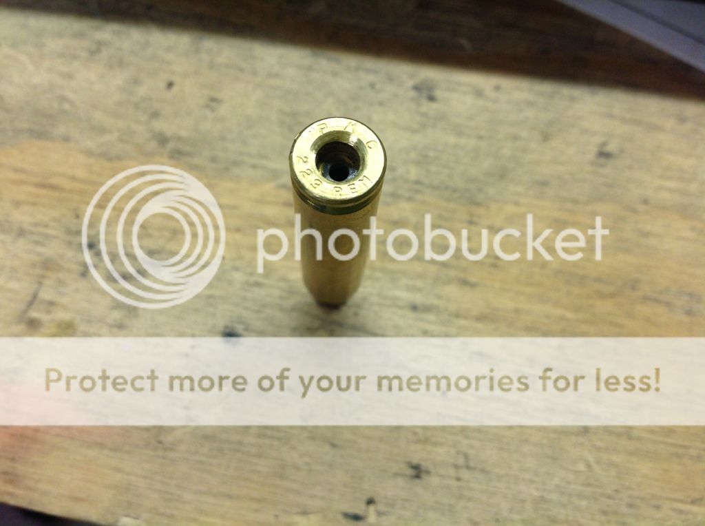

              NEVER use a counter sink bit! I am seeing people now that don't know what they are doing and take away too much brass! People are getting this idea and ruining thousands of pieces of brass!
              Please just spend the money on a quality tool... You guys ruining brass are killing me!
              This is what people are doing
                          That's the "digging to China" I mentioned. When you understand that by definition, HALF of the population HAS TO BE BELOW AVERAGE in mechanical ability/sensitivity, you get China digging. All it needs is a slight chamfer around the primer pocket to remove the crimped portion.
