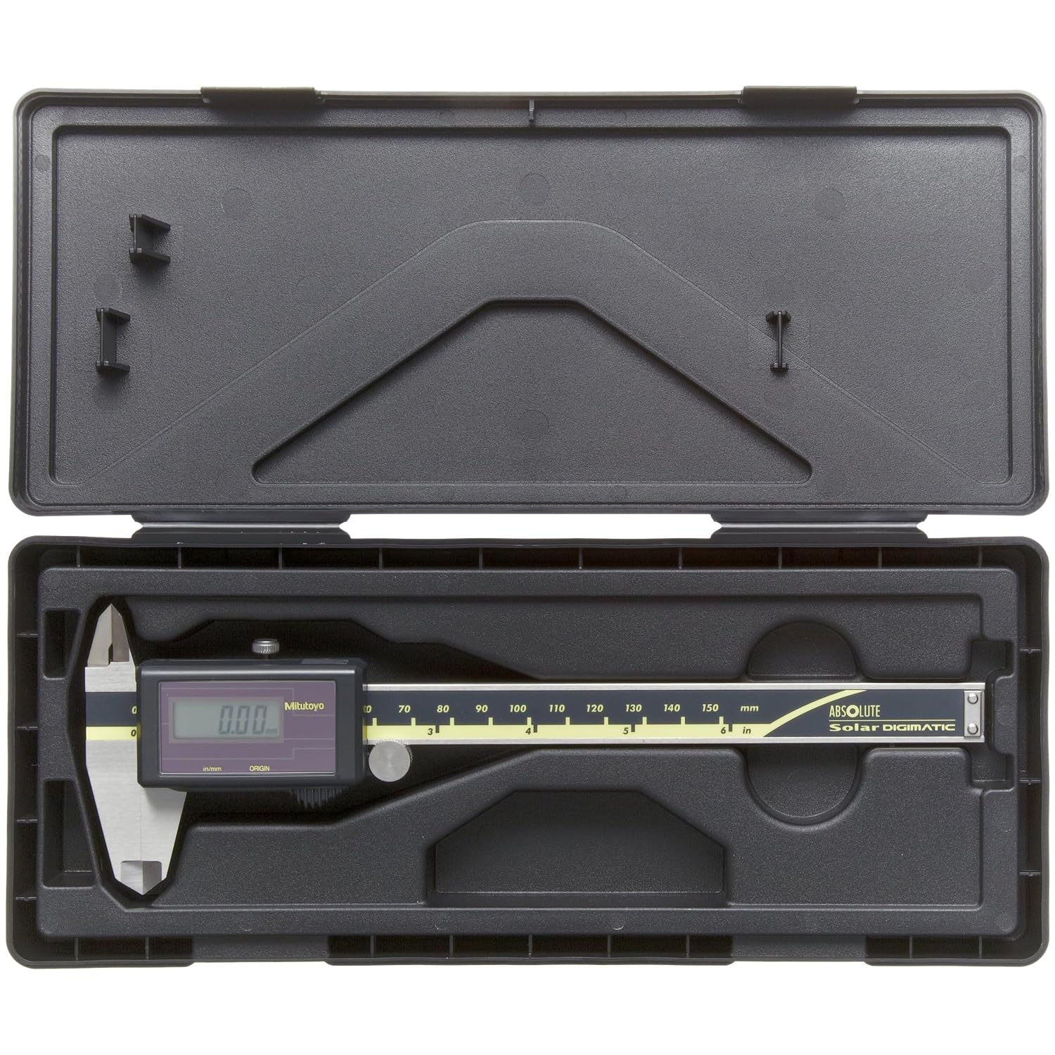

                        If you clamp a headspace gauge onto one blade can you then zero the caliper to start from 1.17 inches open to measure shoulder bump?
                        Dont like batteries buy a solar powered caliper, problem solved!
                        But with batteries being like 10/$1.00 at HF why bother? I bought 2 calipers and have both on my bench with 30 batteries in the freezer. Lifetime supply all with 20% off.

                          Didn't know they made solar-powered digital calipers. That's pretty cool.
