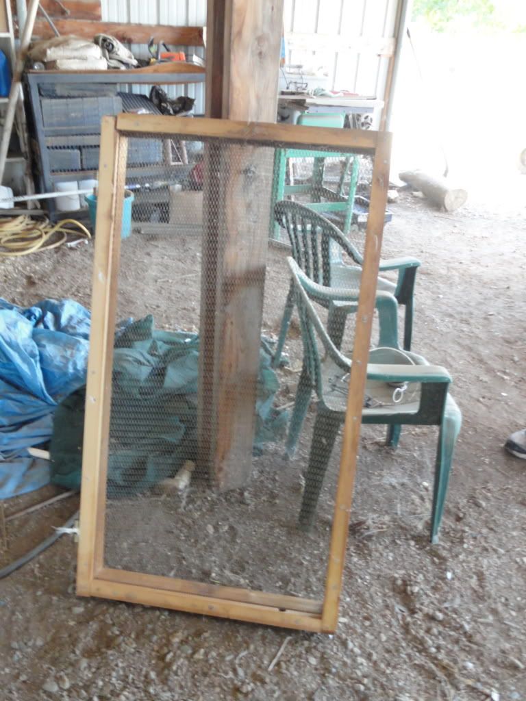

    That's only about a cubic yard, I would build a wood frame with steel mesh that has slightly smaller openings than what you're trying to recover. Prop it up on some sawhorses, shovel in your dirt, use a water hose to spray it if clumps. Think goldminer...

        I use a fine rake and just comb through the dirt, after you find a few they stick out like a sore thumb, might be a little harder if yours are that deep though. I have collected them about 5 or 6 times now and I have a 5 gallon bucket with 3 to 4 inches in the bottom, feels like 40 pounds or more.
        You can make a screen out of 1/4 inch hardware cloth and a 2x4 frame. I did this to screen small rocks out of wash sand for mixing concrete. About all that would fall through would be .22 and .223/5.56.

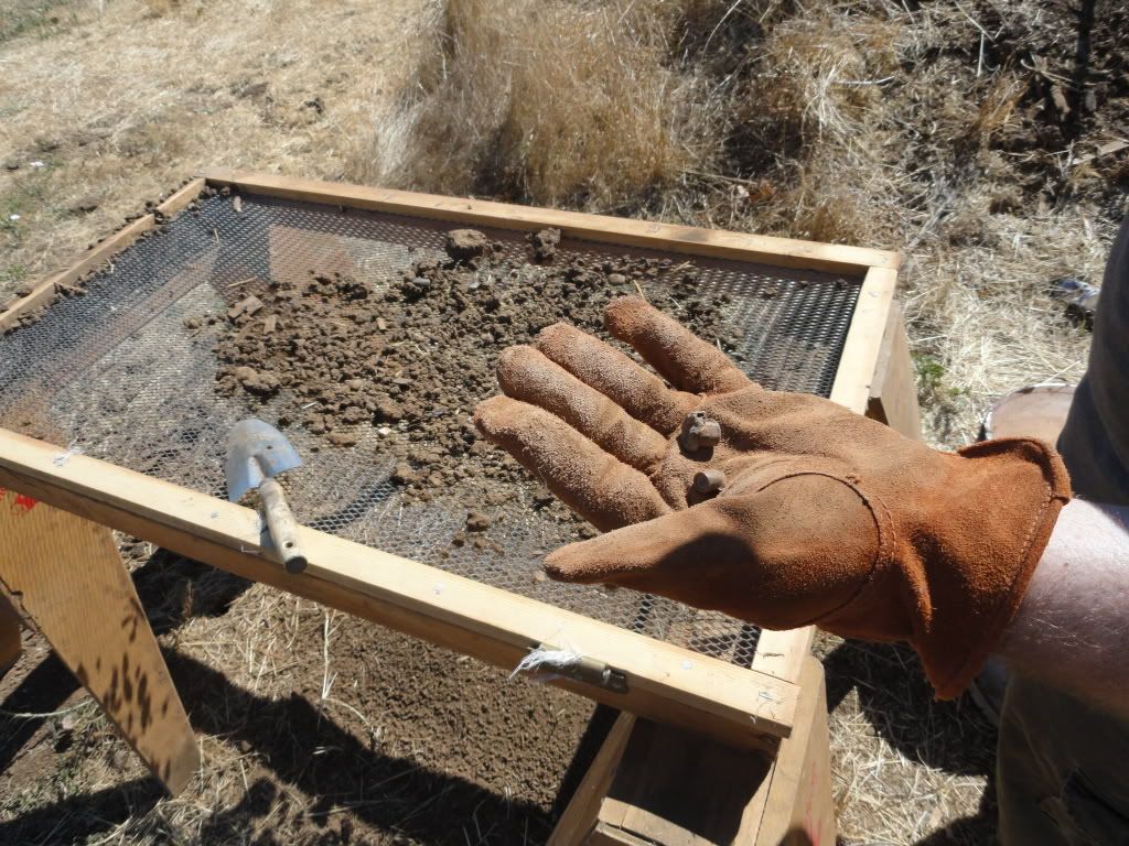

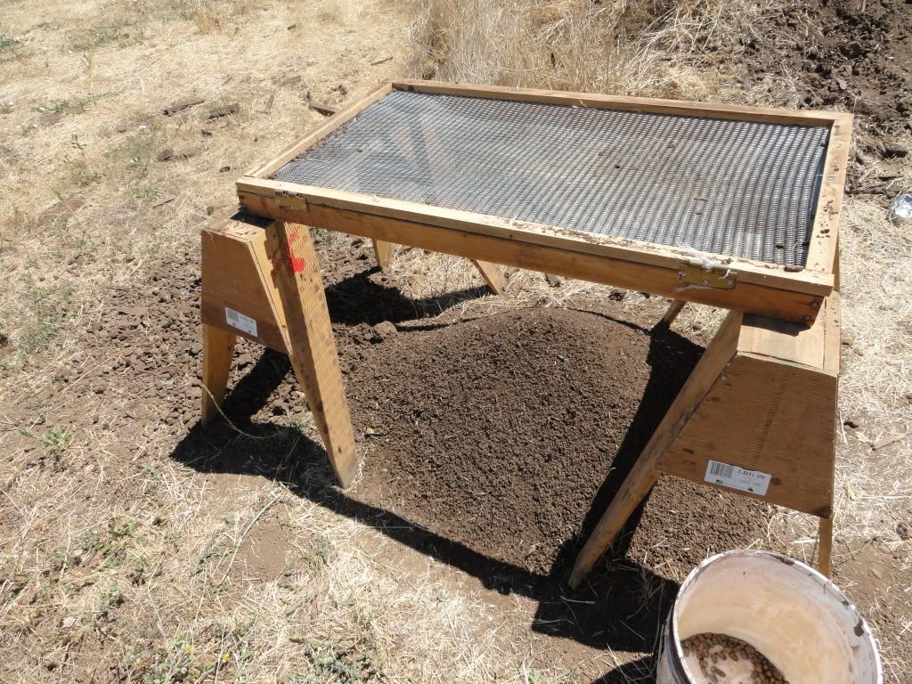

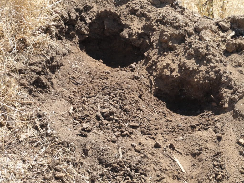

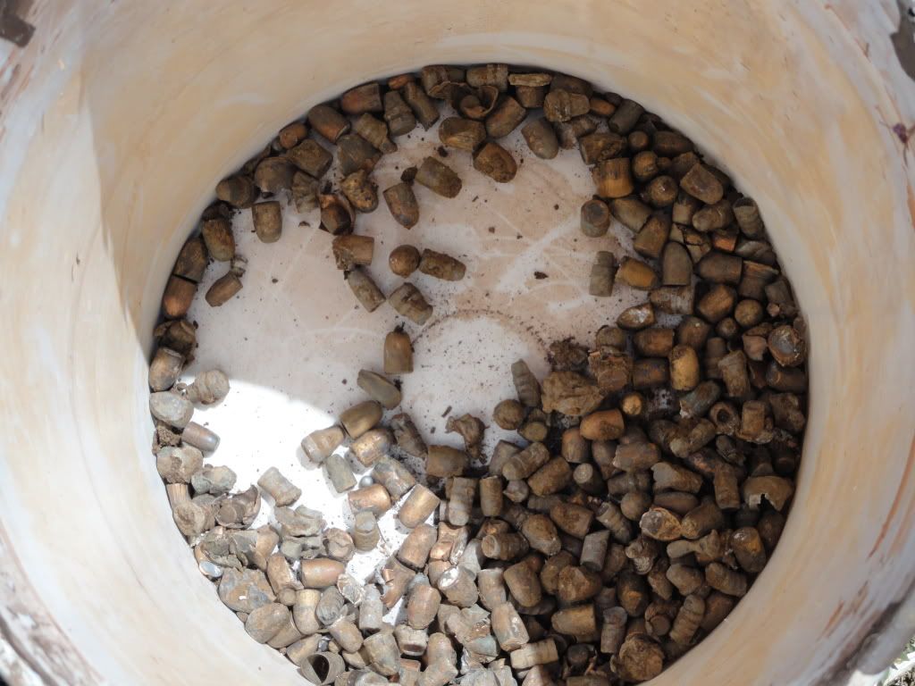

              10#s pictures later.. heat got too much to continue.. lots more dirt to filter.

                    Would it be worthwhile to put the screen over a wheelbarrow? That way, you could move the filtered dirt right after you're done without having to shovel it back into something.
