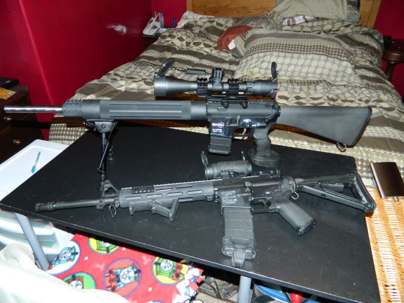

              This is exactly what I have in my 'toolbox'. Havent had a chance to push my RRA Predator Pursuit upper more than 400 yards and Im still trying to find the right load for it. Currently focused with the precision aspect and have had good luck (sub-moa) with 60gr Hornady V-max. Bought a box of 70gr Berger bullets...really need to get back on those.

                      Vinny!!!!!! SEE!!!!!???? Thats what I'm talking about!!!! I want 2 in those types of configurations.
